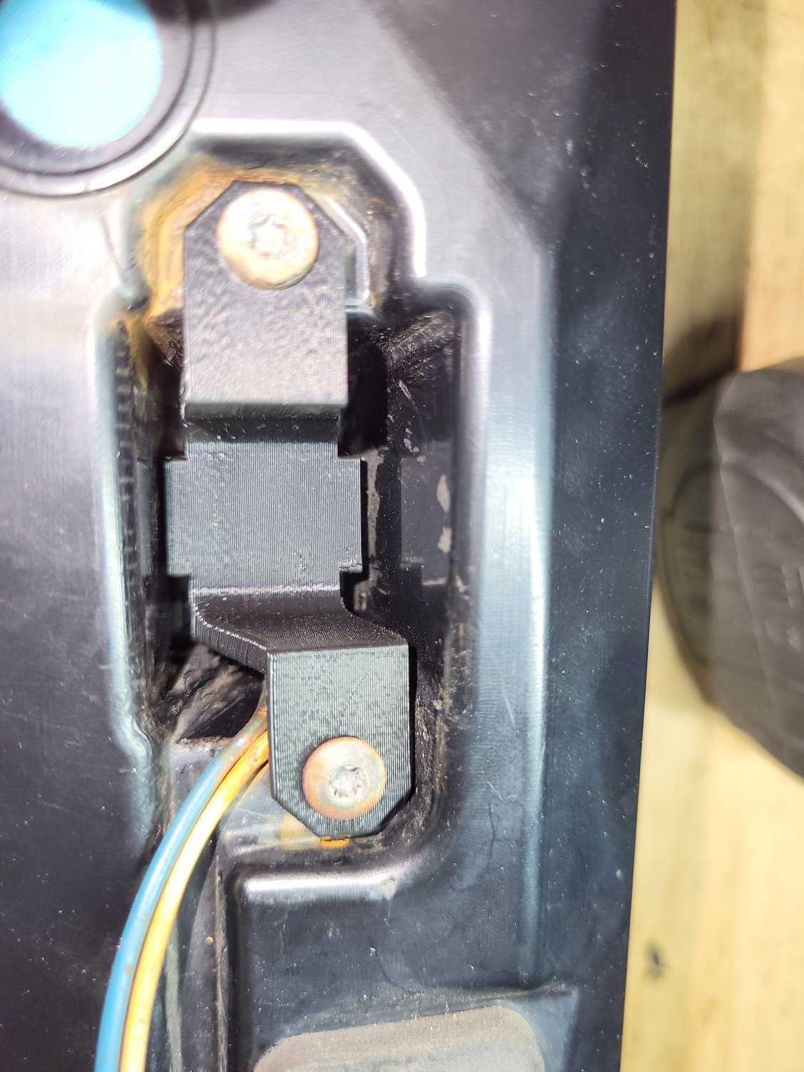

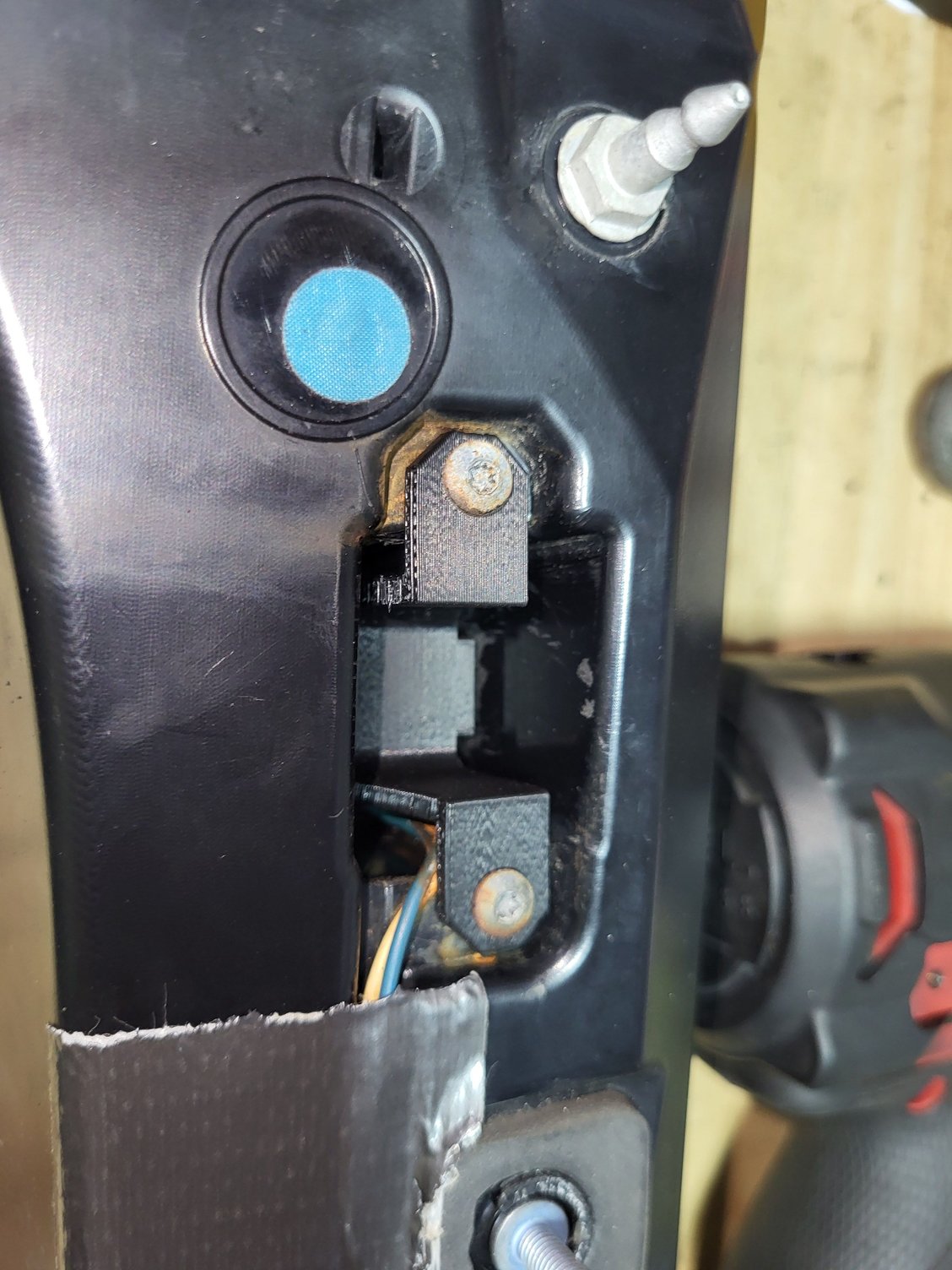

I purchased the bracket and just installed it today after like a week of raining, it took at most 20 minutes you have 8 8mm bolts to get panel out 2 star screws for handle on trunk lid and 2 star screws for bracket the bracket is wayyyyy stronger than the flimsy piece of garbage dodge uses thanks Ben again for having the ingenuity for creating this saving me 1450 here in NJ. From time of contact to in my hands was a week and worth every penny. Now on to the next project with why are my interior door panels all raised at top on my front doors.

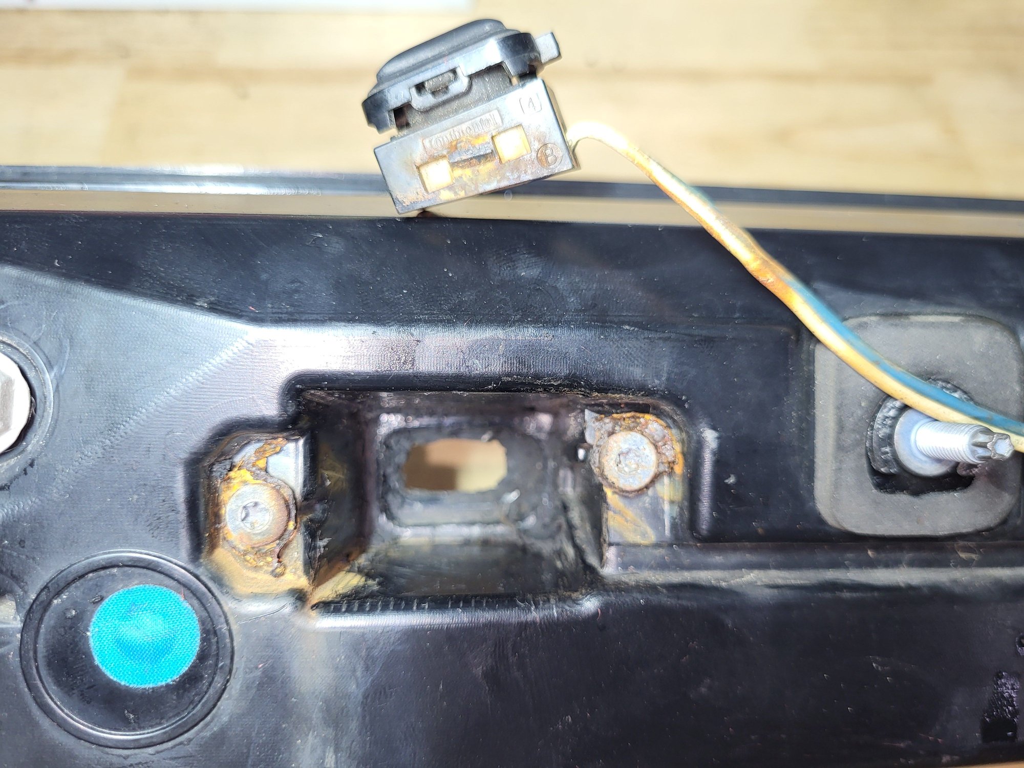

Shout out to BAM! I ordered one of his 3d printed trunk button brackets since mine rusted out. He got it to me quick and it fits perfectly. If anybody has the issue talk to BAM he will get you squared away.
