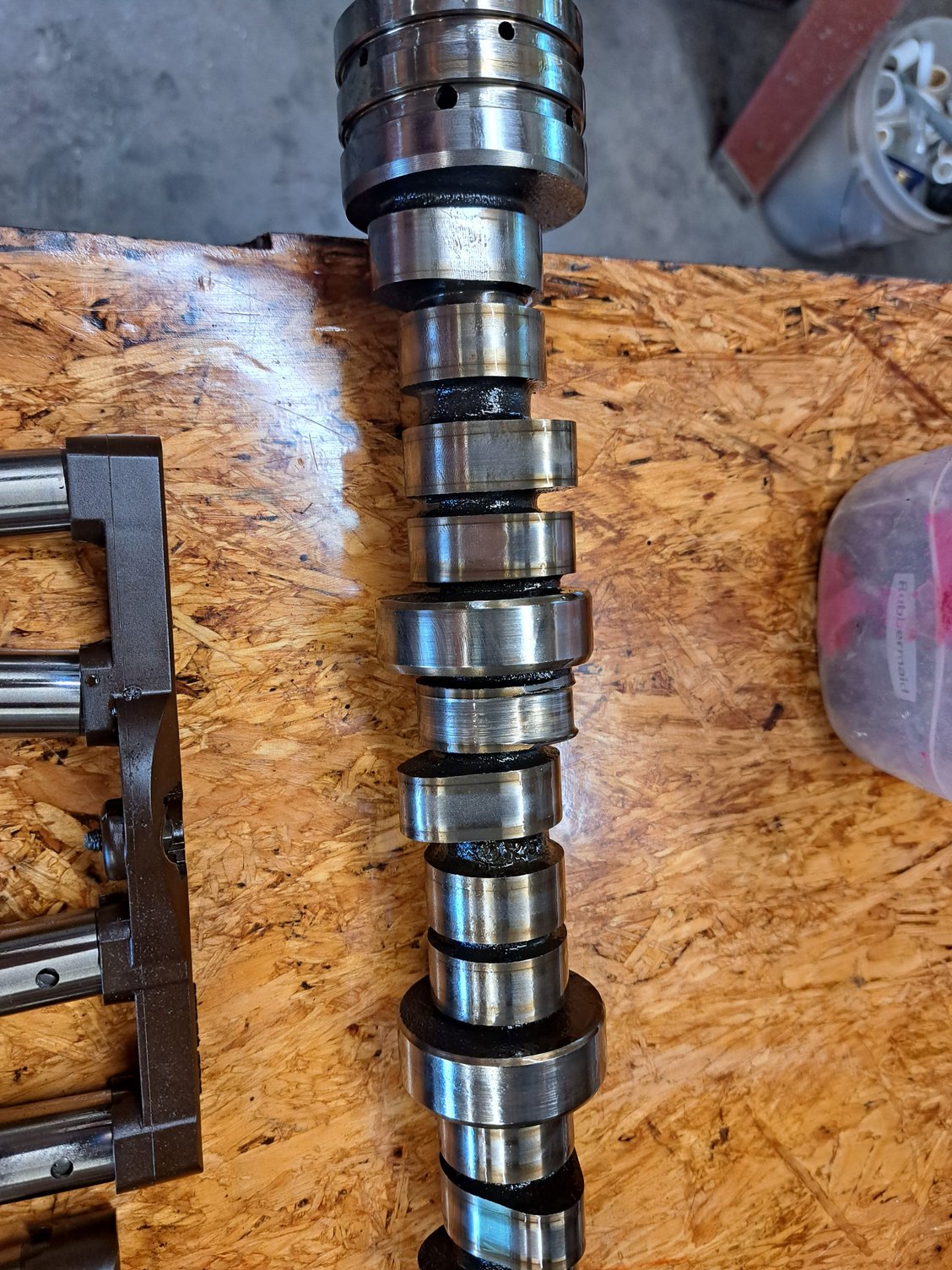

So, here's a little update. The lifters came in and they are indeed four to a box. I pulled the heads and then the lifters. I was glad to see no obvious damage to the lifters, but that ended when I scoped the camshaft.This is what I found.

So, I have 8 more lifters and a camshaft on the way. I also discovered my carrier bearing is shot. That is incoming as well. I have to wrap up in a bit and will jump back on it Thursday. I'll keep y'all posted.....

The Charger was finally reassembled last Thursday. I left the old filter in but replaced the oil and drove very conservatively for about 200 miles. So far, I have no problems. The carrier bearing was the absolute worst part. It took a vise, an acetylene torch and copious bad words to get the mechanism apart. It took more bad words to get it back together. A one piece driveshaft is definitely in my future.
I ran the misfire test. No more misfires. The MDS system works more smoothly than it used to. I will dump the oil and filter today, then drive as normal.
If someone can weigh in, do you run oil additives? If so, what do you use? I was recommended and used Hot Shot's FR3 Friction Reducer. Since the cam swap and fresh oil, I lost about 1 MPG. IDK if the new parts wearing in or the lack of the additive is the cause.
