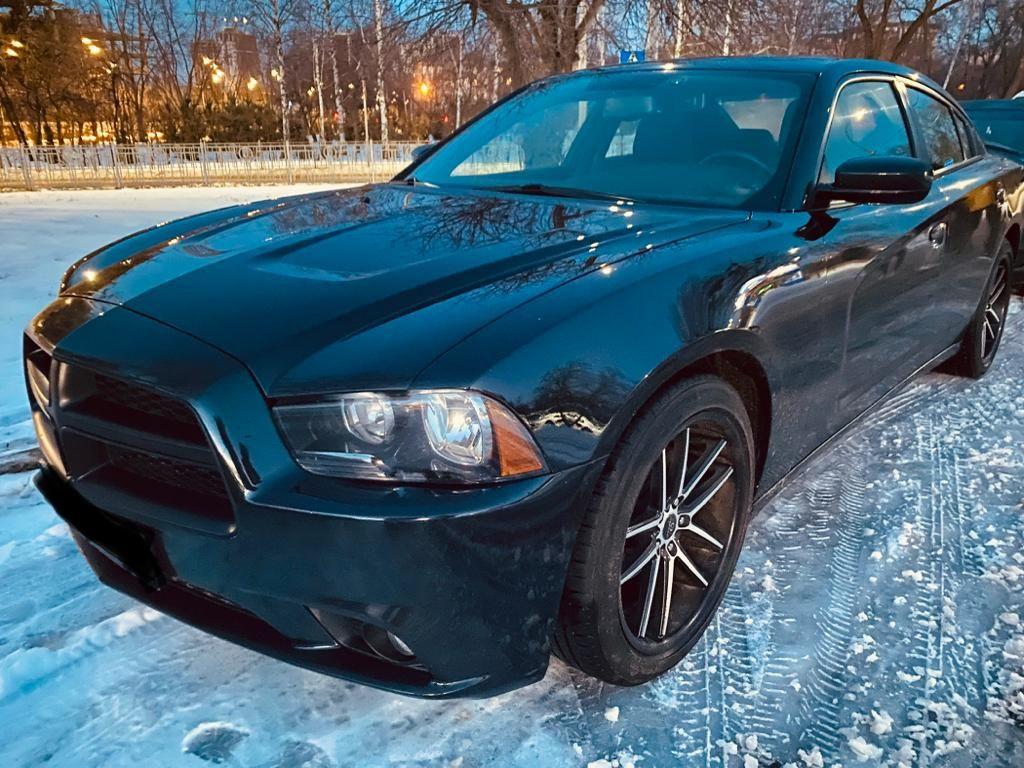

Hola a todos, soy nuevo en el foro y estoy buscando ayuda para mi coche. Se han doblado 4 bielas de motor y me han dicho que es muy dificil repararlo y que solo perdere tiempo y dinero y no se si es real, tambien queria preguntar por motores compatibles con otros modelos o marcas ya que me dicen que lo mejor seria comprar un motor nuevo pero yo estoy en espaņa y aqui no se reparten motores nuevos, tendria que pedir y entre el motor nuevo y aduana me costaria mas de 9000 dolares, entonces busco a alguien que sepa del tema y

Bent connecting rods? Are they sure?? What was going on when that happened??? That's a rare one.... bent pushrods I could see, and are easy to replace, but, connecting rods???? HHhhhhmmmmm.

Yes, the engine overheated and the gaskets came out, for this reason water got into the engine and that is why it bent

Yep, that's toast. Bummer. Parts would be cheaper to ship overseas..... but, god only knows what other damage it did. Could you maybe find a parts car, one with a bad trans, or something? Maybe one that got hit, but the engine survived?
Might check RockAuto UK version, see if they offer anything. Might be a bit cheaper.

It's a 3.6, DOHC..........no pushrods.
Full translation for everyone else:
Hello everyone, I am new to the forum and I am looking for help for my car. 4 engine connecting rods have bent and they have told me that it is very difficult to repair it and that I will only lose time and money and I don't know if it is real, I also wanted to ask about engines compatible with other models or brands since they tell me that the best thing would be to buy a new engine but I am in Spain and new engines are not distributed here, I would have to request and between the new engine and customs it would cost more than 9,000 dollars, so I am looking for someone who knows about the subject and can help me
Any longitudinal rear wheel drive (or Grand Cherokee only four wheel drive) 3.6 engine will work; that includes Chargers, Challengers & 300's 2012 and up; Grand Cherokees & Rams 2013 and up. Absolutely no sideways (front wheel drive) engines, they are built differently.
