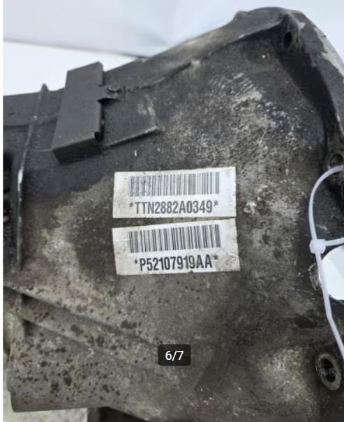

I am in the process of restoring a 1971 Charger and I want to convert it from automatic to manual.

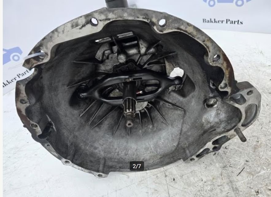

I found a transmision from a RAM 1500 V6.
Does anyone know if it fits on a 318?
Before I go and buy it.. ;-)
Greetins from Belgium
Tom
Some more info:
Article number: P52107919AA, TTN2882A0349
Classification code: A2
Engine type: Petrol
Engine code: EKG
Displacement: 3,701 cc
Gearbox: 5 gearbox
Gearbox type: Manual
Gearbox: 5 gearbox
Drive: Rear wheel
Gearbox Code: P52107919AA

If it was the 3.9 V-6, bolt pattern is the same as the 8's.
