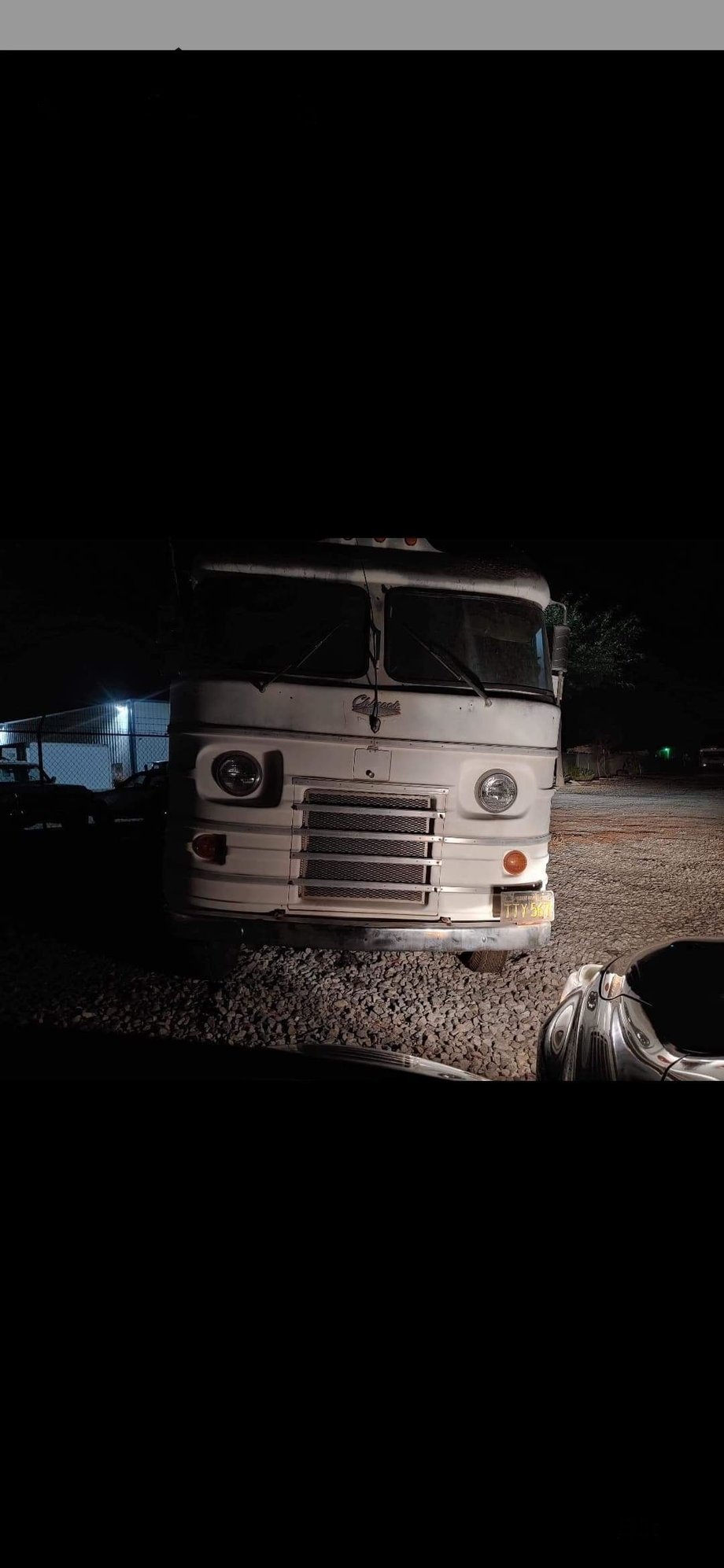

Hello to you all from the uk!
here is my latest purchase a 66 dodge chinook mobilodge
I am trying to findout whta chassis they are built on
so i can buy some parts before i ship it to the uk
thanks in advance for your help

See if you can find a data plate for the chassis showing the rear axle capacity. I'm thinking they were built on a 2 1/2 ton chassis. Similar to what full size school buses are built on in the U.S.. What engine does it have? Is the distributor in the front or rear of the engine. If it's in the front, there will be some numbers stamped on the flat section under the distributor. These will give you the engine size. You probably have a heavy duty Torqueflite transmission called a Loadflite.
Old Oct 19, 2019 | 11:15 AM
Moparite's Avatar
Moparite
Joined: Feb 2015
Posts: 7,435
Likes: 578
Dodge chassis according to the link. I would think it would have a big block or 318 poly.
https://tincantourists.com/wiki/chinook/
Vin decoder may help ?
