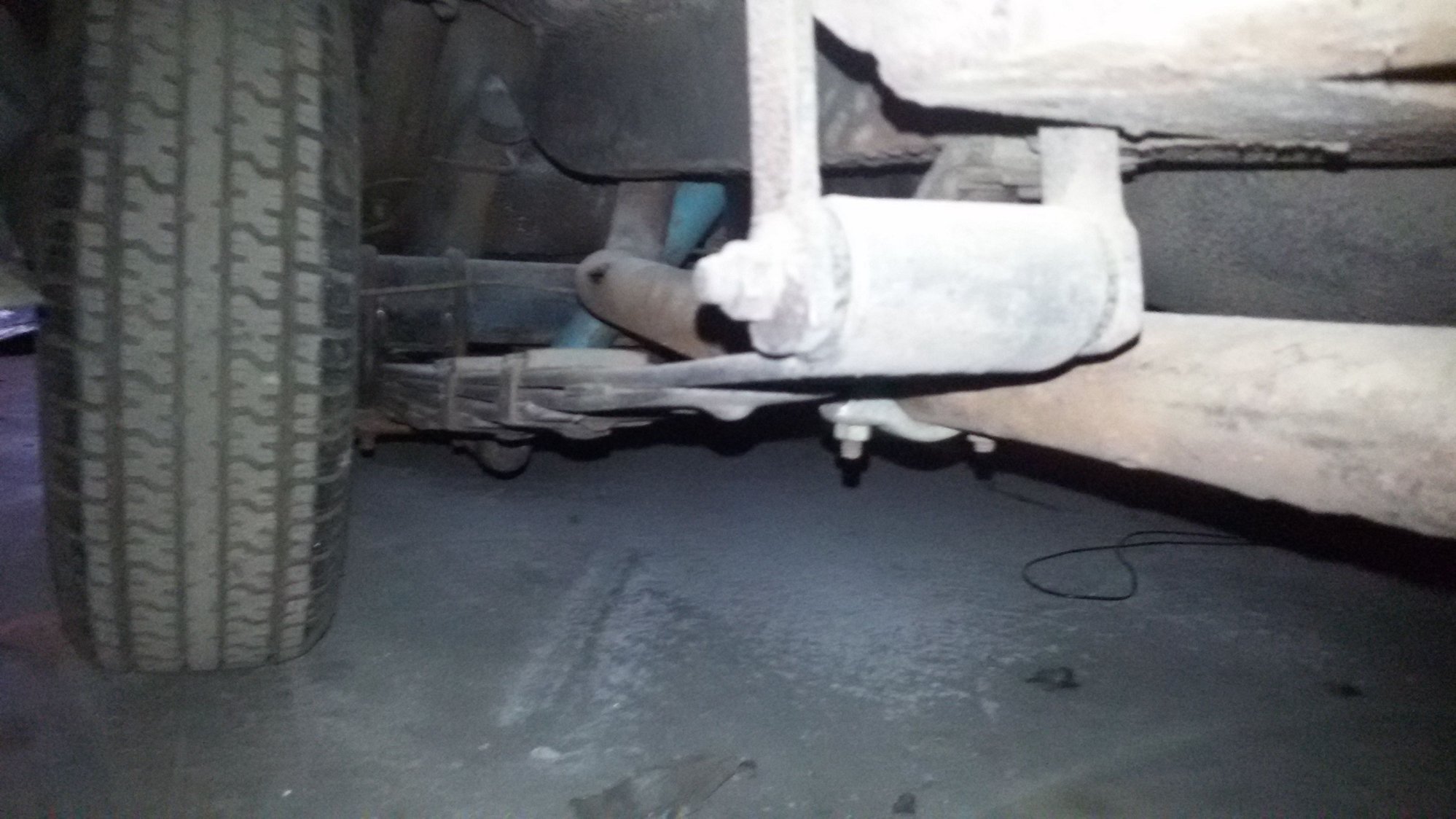

I'd really appreciate some input from forum gurus once I am in the process of pushing my 1976 4 door Dart (318 V8 / A904-LA) out of the garage after quite a long sleep. I've fixed a bunch of stuff but the list keeps growing...
My question is about adjusting this 4 door dart riding height. I am quite sure the rear leaf springs did sag quite a bit.
Front height is easy to adjust once it's got torsion bars but I think the rear bumper should be about 2 inches higher than it is now after 40 years.

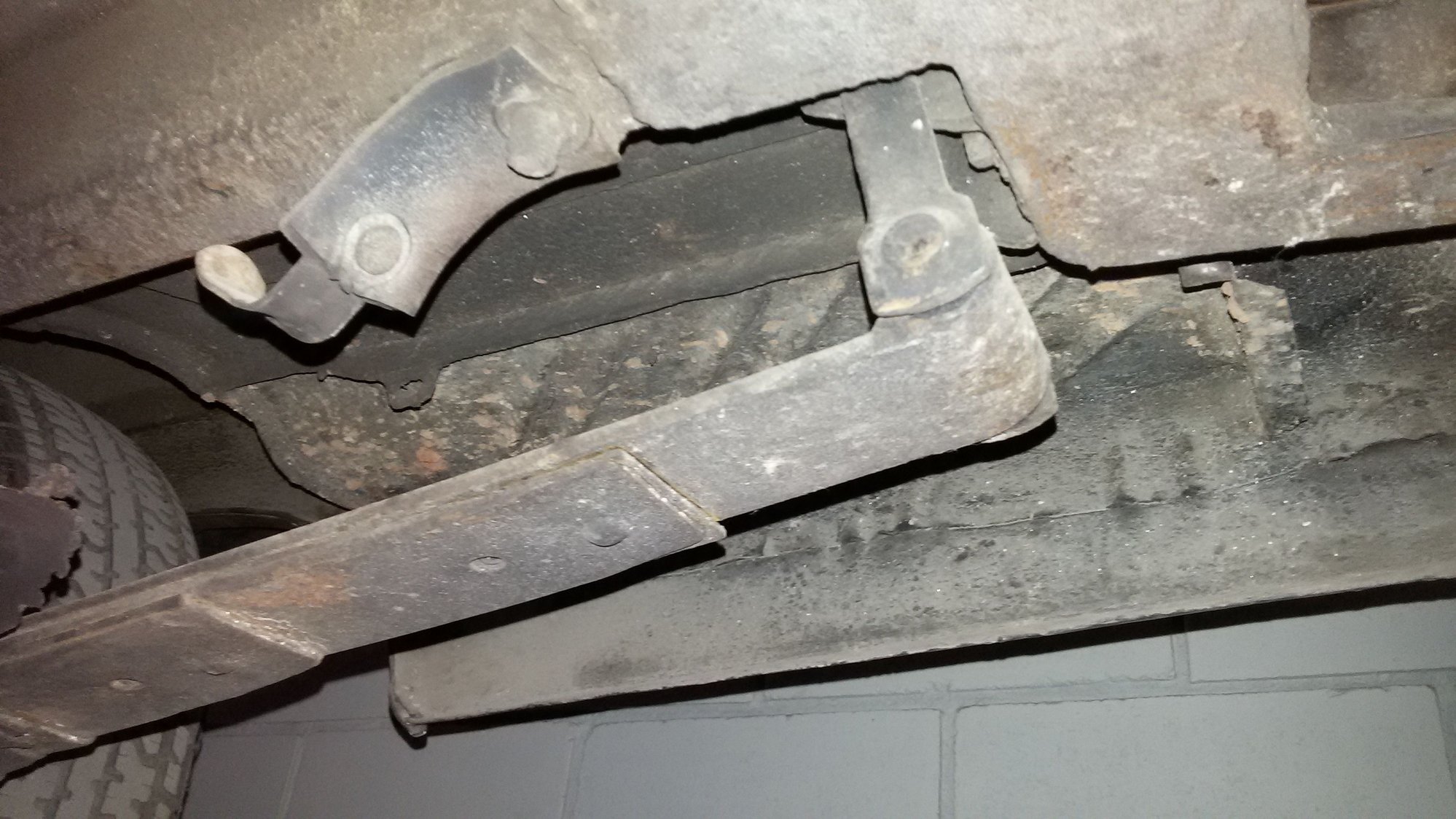

Here where I live there are no parts and mechanics are really my last option, now question is, could I fabricate a pair of longer shackles, something like 1" or 1.5" longer than stock to set the rear height where it should be without having issues with pinion angle, vibration, etc...
Rear leaf springs shackle as is 40 years
I'll post pics but having some trouble with that right now...
My other option would be take the leaf springs to be re-arched but I want to avoid that as much as possible, the car is just a weekend short rider now.
Thanks in advance.

If possible,get them re-arched-rebuilt.40 yrs old there due.Longer shackel will be a bandage for what it really needs,rebuilt.Just a thought...........

Thanks CRUZER55. I know it would be better that way but I'll have to find new brackets and rubber to reassemble, maybe bushings too, i don't want to replace all parts, just what really needs to be done because I have to import all parts and that is really costly... Once I seen quite a few cars with longer shackles I am just exploring that possibility...
