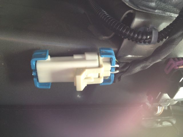

I was looking under the backend to see how much work it's going to take to install the receiver and wiring my self when I spotted a 5 pin connector that was plugged into a shield. It looks like it may be a trailer lighting connector but I cannot find any information about it. Does anyone know anything about this connector? Pictures below.

Most likely, even if it came with a 7-pin connector, only 4 would be supported. My tow harness that came with the tow package only has a 4 pin connector. The DJ is not a "tow machine" and is not rated for anything that even remotely comes close to needing a 7 pin connector. If you got that cable, you'd, more than likely, find that only the 4 pin is usable and it will be the usual 4 pin connectors; lights.

I have found the older harness which does not use that 5 pin connector but instead connects into the lights and uses a totally different controller. It is a 7 pin design and comes with the 7 to 4 pin adapter. You still have to add the brake controller wire into the 7 pin connector if you going to use one. Down side is that it runs about $225 and takes a couple hours to install but no flashing required for it to operate. It's still listed for the 2014 Journey so maybe they figure the cheeper one for those that only need to tow a trailer from the local rental yard and the larger one for those that want all the extras. However if the dealer want $150 just to flash to enable it you lost all of the savings.
Anyway, thanks for the information about what comes with the harness. Knowing that it has three relays says a lot. My initial take is that there is a ground ring on the harness and the connector has 12V, Left Turn, Right Turn, Stop and Tail lights. The 3 relays would be for Left Turn, Right turn and Stop. The strange thing is that normally there is a relay for the Tail lights So either there is a forth really, one of the relays is really two in one package or the tail light relay is built into the Journey. I'm guessing it's the last option.

The DJ is not designed for towing; that's why it only comes with a factory wiring harness to support a 4 pin, lights only, utility trailer connection. Can you add a 7 pin connector? Sure, you can buy adapter trailer wiring kits and add a 6 pin or 7 pin connector harness, but, since the vehicle itself isn't capable of utilizing a trailer with those needs, the factory doesn't provide the onboard capacity for it. Vehicles designed for towing, such as my RAM CTD, come with the proper wiring for 4 pin and 7 pin (and I have a 6 pin adapter), but, even then the backup light pin-outs on the 7 pin connector are empty...as I said, even larger trailers that might benefit from backup lights, don't come with them, so, the pin-outs for those on the vehicle are empty. You can add the wiring straight from a fuse block to power backup lights, but, then you need the wires both for the vehicle and for the trailer, light installation on the trailer, etc. to have backup lights that really aren't necessary; an added cost that most don't bother with. I've had the need for lights when backing up in several instances. I have magnetic LED flashlights with huge amounts of light output that I turn on and attach to the trailer's bumper or frame. Very little cost, high light output, aimable and there when I need them without having to run wires anywhere (and wire starts getting expensive when you are talking about 35 and 40 foot long trailers.
When I have the time to dig some more I'll look into it, but, thinking about the current harness design, the 5th line may be a 12 volt power source and the relays may supply unregulated 12v power for the trailer's lights. The new DJs come with LED tailights and the CANbus is designed for supplying adequate voltage and current for them. That CANbus supplied current may be inadequate for incandenscent lighting on a trailer (most don't come with LED lights; I've spent a fair amount of money and time converting all of my trailers to LED) and the relays may detect the signal and then control 12v, unregulated power, in the proper sequence (flash or on) to the proper lights. Maybe someone from Dodge (the Dodge Cares Group) can shed some light on the need for the relays and 5 pins for a 4 pin output. Common trailer harnesses don't require relays as they splice into the lighting circuit's output or use adapters that plug in between the vehicle's wiring harness plug at the tail light assemblies. There must be a current issue for needing 3 relays on a 4 pin cable assembly.
