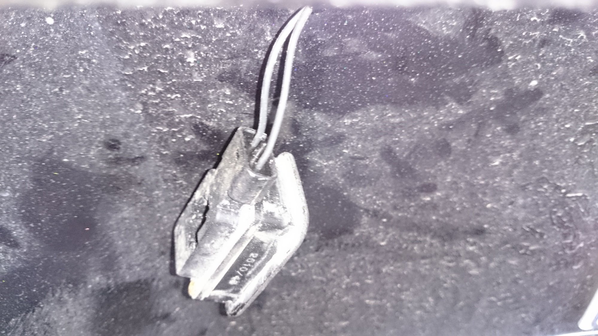

It has the 8.4 screen with satellite radio. I noticed that it already has a plastic cover where the backup cam would normally be and by popping it out with a flathead screwdriver, I noticed that it's attached to 2 grey wires (I'll add a photo soon). Does that mean my journey is already pre-wired and I could just buy a camera, plug it in and it would work right off the bat? If so, do you have any suggestions about where I could get one?

As for the camera a pic of panel you looked at would help usually
cams are mounted at center above rear plate.

thanks for the info, here are photos

I am afraid you have mistaken the remote lock/open button
located on the hatch at least that is what it does on my '11 SXT.
If you have the key fob with you is operable.

But my key doesn't have a remote hatch button...

ok I tried it and see what you mean. Could my car still be pre-wired? Otherwise, is it impossible for me to add a rear view cam?
