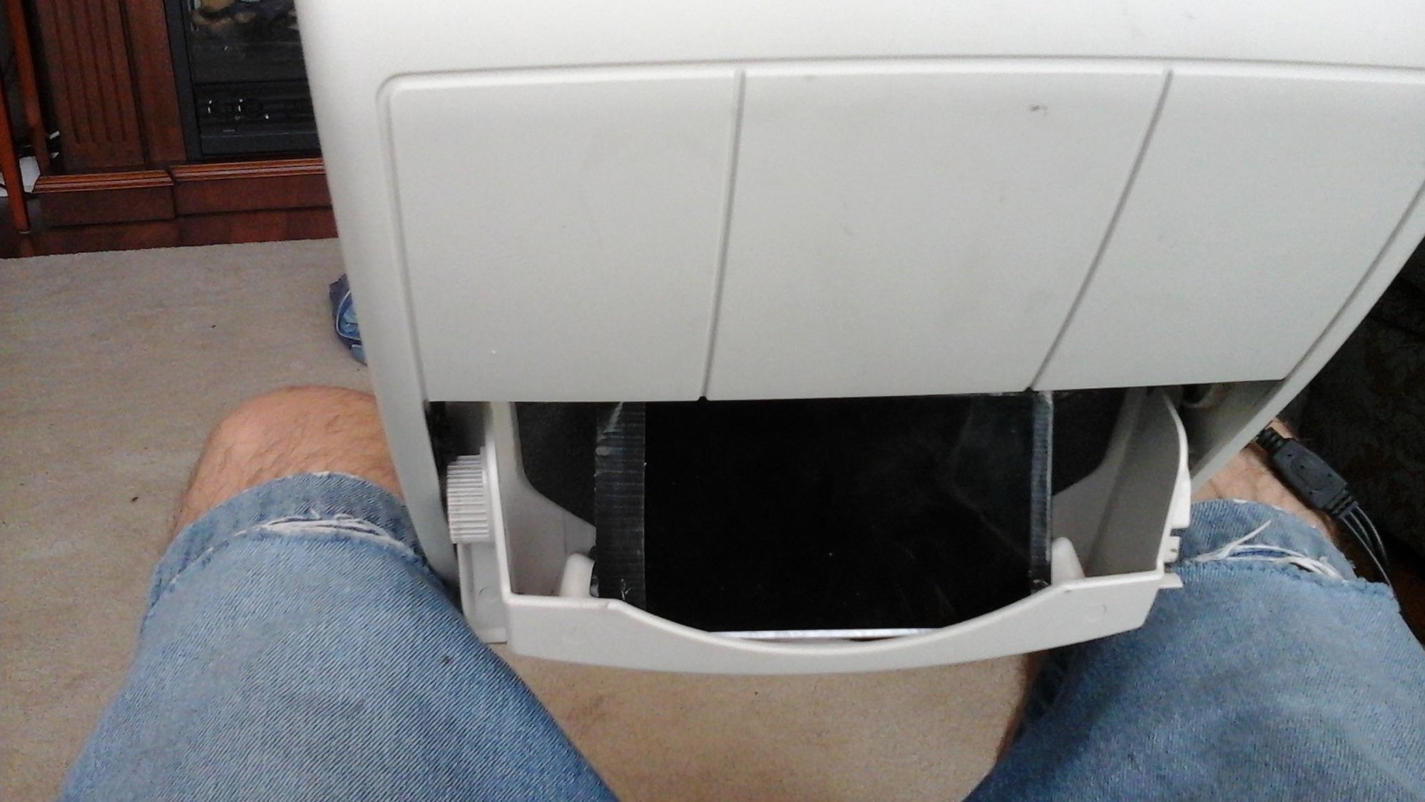

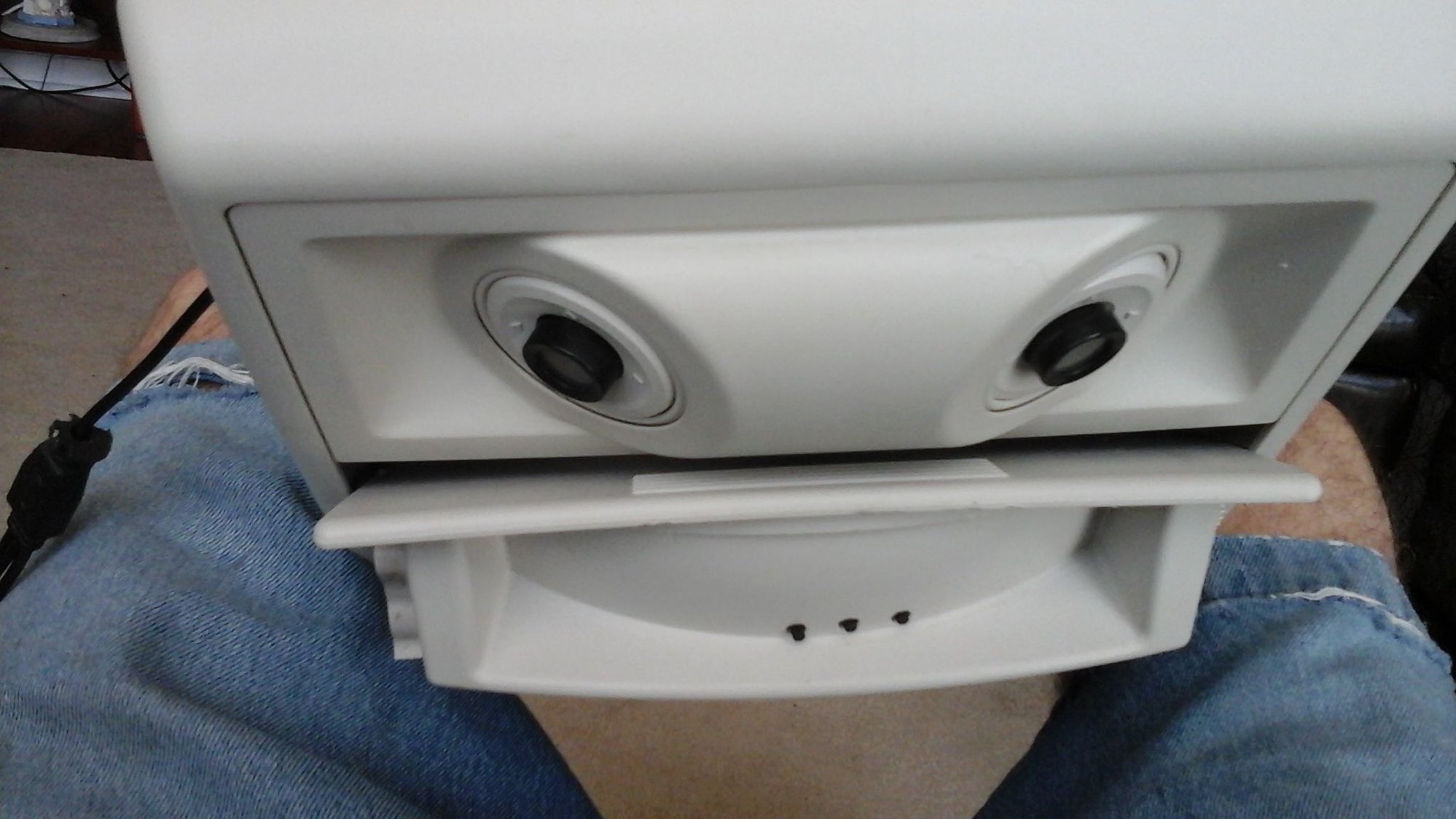

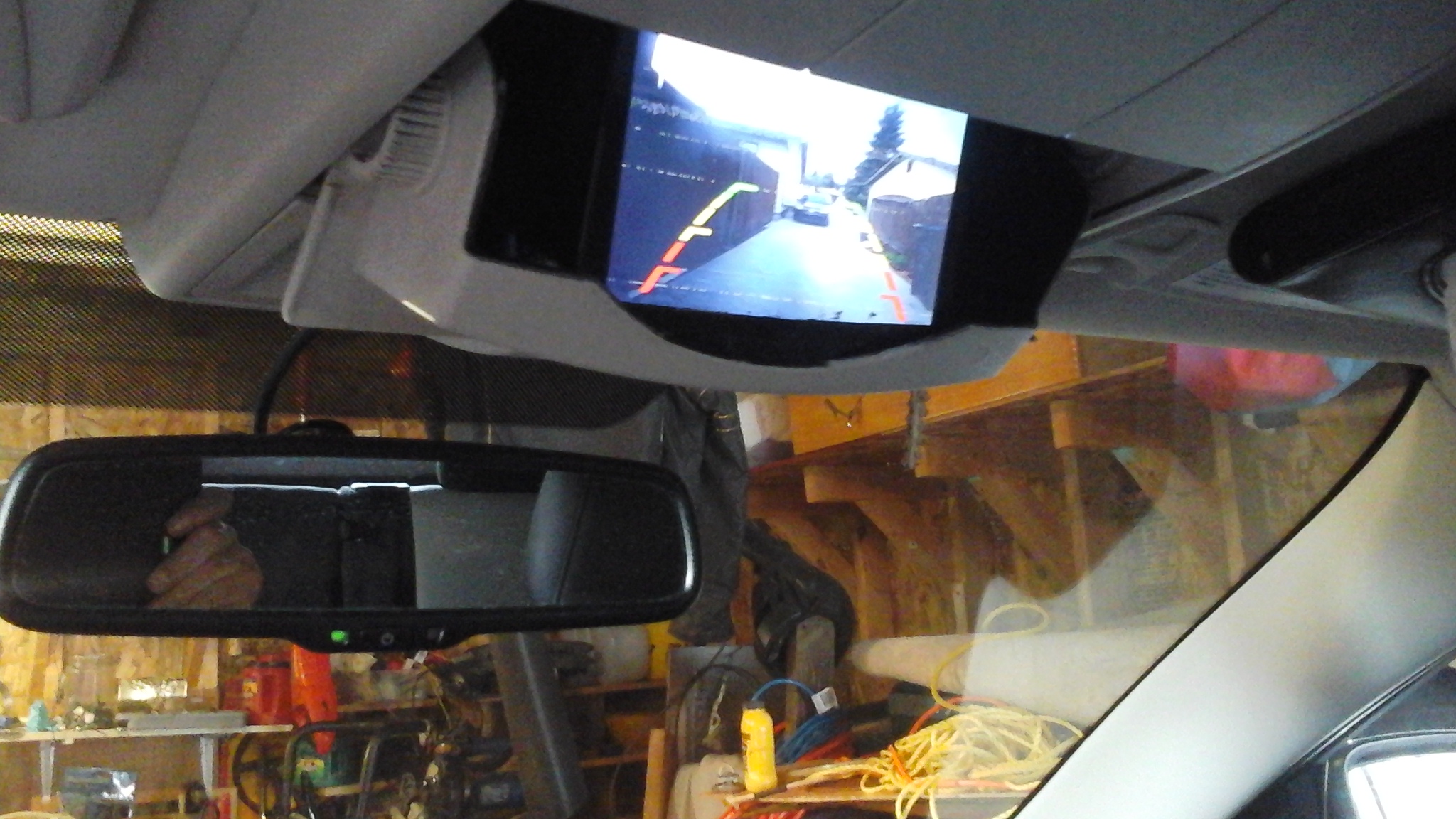

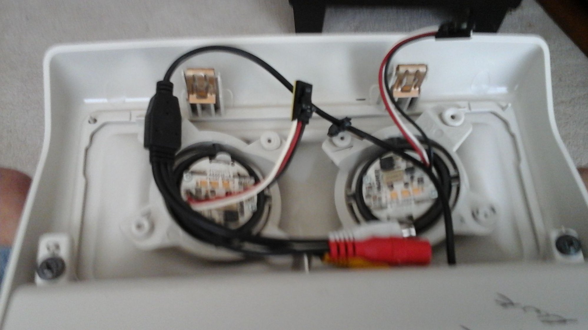

So I bought the wireless TX & RX the camera was a snap. At first I have a rear view snap on mirror monitor but the wife said it made things fuzzy so I ordered a 5" monitor. But I took the mirror monitor apart and it had a thin 5" monitor and a 3 button control board, hmm I trident it with a video signal and it was pretty good. Then she started on about that over head consol and how it was hanging down again. I checked yhe size and that monitor would fit. I beetle over to the salvage yard and bought a complete overhead consol and took it apart, I had to drill 3 1/8 " holes for the control buttons a 3/4 from the power and video cables see photo. Now is that red wire to the lamp 12 volt?? Cause if it is I can wire the poem to the RX and monitor.
it is just a mockup right now, because she is away with the car. That sunglass holder is down so I will see if it is acceptable to her.
OK update I hooked it up and the power wire from the monitor to the white 12v wire, it works fine when I put it in reverse but once out of reverse the screen flashes intermittently I pulled the unit out and plugged in a 12v battery and not flashing, so I will have to find another 12 volt source or check the

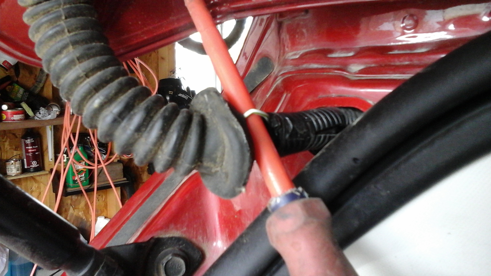

Ok I found the problem and the solution. The system works but once you shift out of reverse the monitor flashes steadily. The problem is it is a 2.4 GHZ system and lots of other things use that frequency, the wireless receiver turns on the camera when it senses a signal any for you radio guys, there is no squelch control.

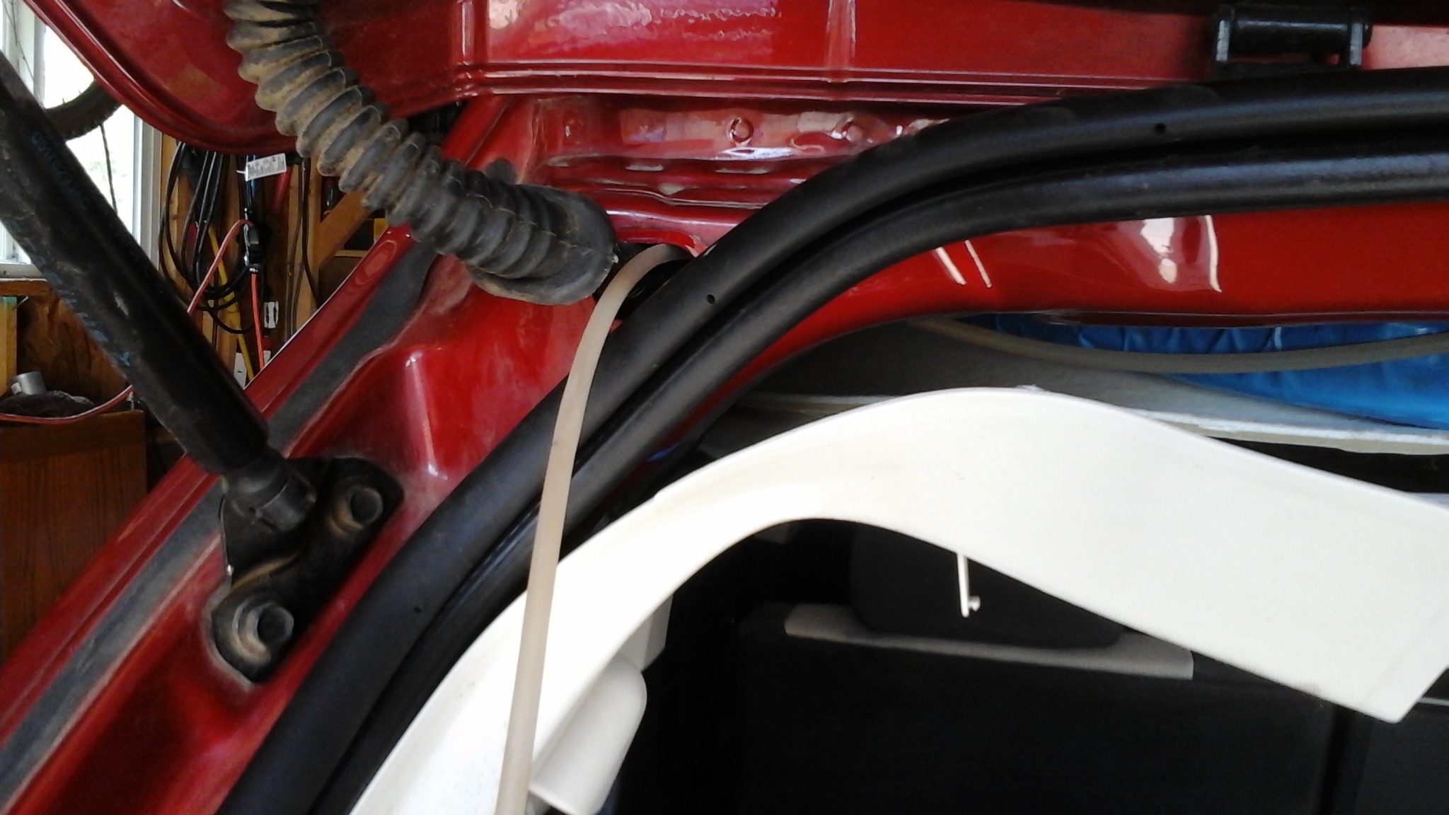

So the solution, run a 12 volt per line to the receiver from the reverse light light. Now the receiver only gets power when you go to reverse. If you look at the top of the open tailgate there is a cable housing, pry off the cabin side and you will find the white with green stripe backup power wire. It isn't to hard to run a wire from the back to the overhead consul and the receiver. The solves the problem and you only have to remove one torqued screw enclosed are the pics
