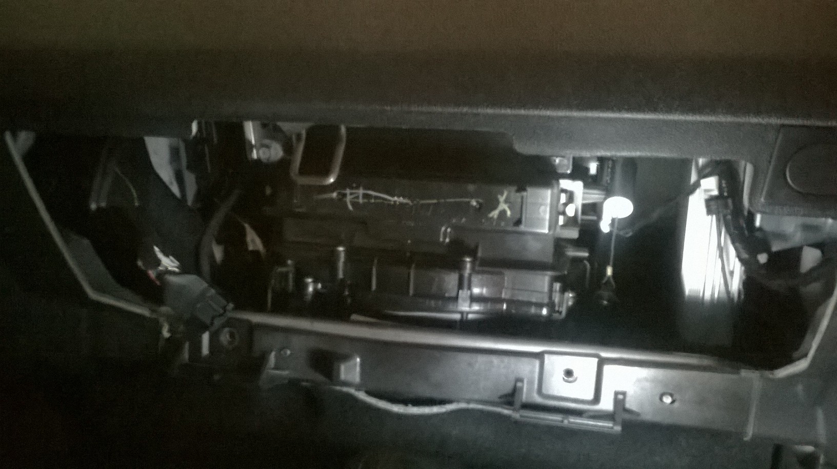

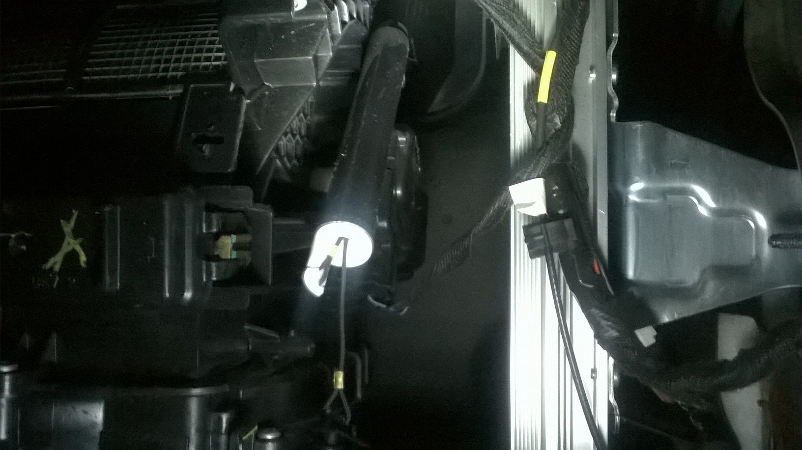

Is this it on the right side of that ventilation box behind that white thing that holds the lanyard for the glove box? (There's another actuator looking thing on the left side of the box but I'm betting that one is for the driver side.). If that's it, it looks like fun, because the screw heads are sideways and not coming out at you.)
