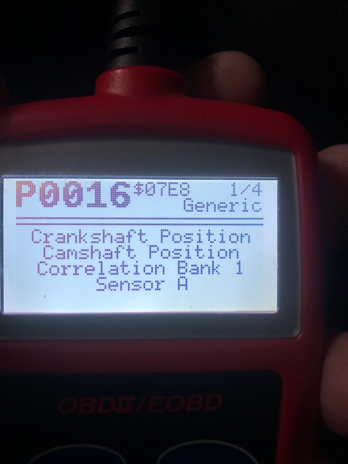

Journey bought with p0300 code. Multiple cylinder misfire. Mechanic replaced plugs, coils and injectors. Idles and can rev up in park and it does fine now. Put in drive or reverse and it starts with the multiple cylinder misfire and after test drive it wouldn’t go past 2,000 rpm and gave a p0016 camshaft and crankshaft position sensor bank 1 sensor a correlation code. Any ideas what I should do next?

it is possible that the crankshaft and camshaft positions sensors need to go through a relearn procedure. This however requires a dealer level scan tool.
