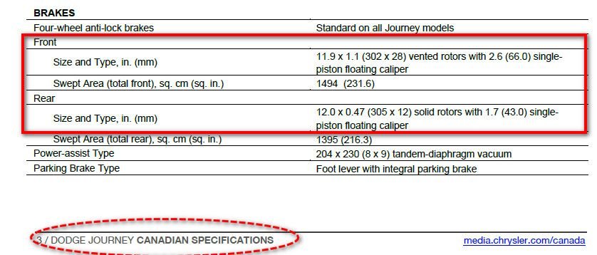

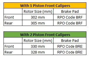

I am trying to buy a Kit (Rotor + Pad) from Rockauto but their website lists 2 different sizes of rotor. They also have this so-called RPO Code BRE or BRF, whatever that means. Any body here bought a kit from Rockauto for the same model/year? What is the correct Rotor size? Any confirmation would be appreciated as return-shipping can be very costly if I order the wrong kit. (Canadian Eh!)
I got a little confused because as I downloaded a 2013 Dodge Journey Canadian specifications, it shows "Single" Front Piston Floating Caliper. However, this is not what I see on my vehicle. I am pretty sure I have 2 Piston Front Caliper and 1 Piston at the Rear.
Btw, I bought this vehicle 5 years ago "Used" so I am not entirely sure of the Trim level. OBD scanner shows "SE" Trim but as I google about it, it's either you get "Canada Value Package" or "SE Plus(+)". Not even sure if this matters...
2013 Dodge Journey Canadian Specifications

If you have 2 pistons, order accordingly. Or, drop by an auto parts store and have them look them up.
