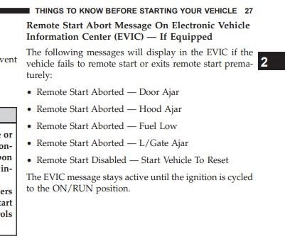

Check the owners manual for things that can cause the remote start to turn off.

I already looked. There's nothing in the Manual about issues with the remote start.
