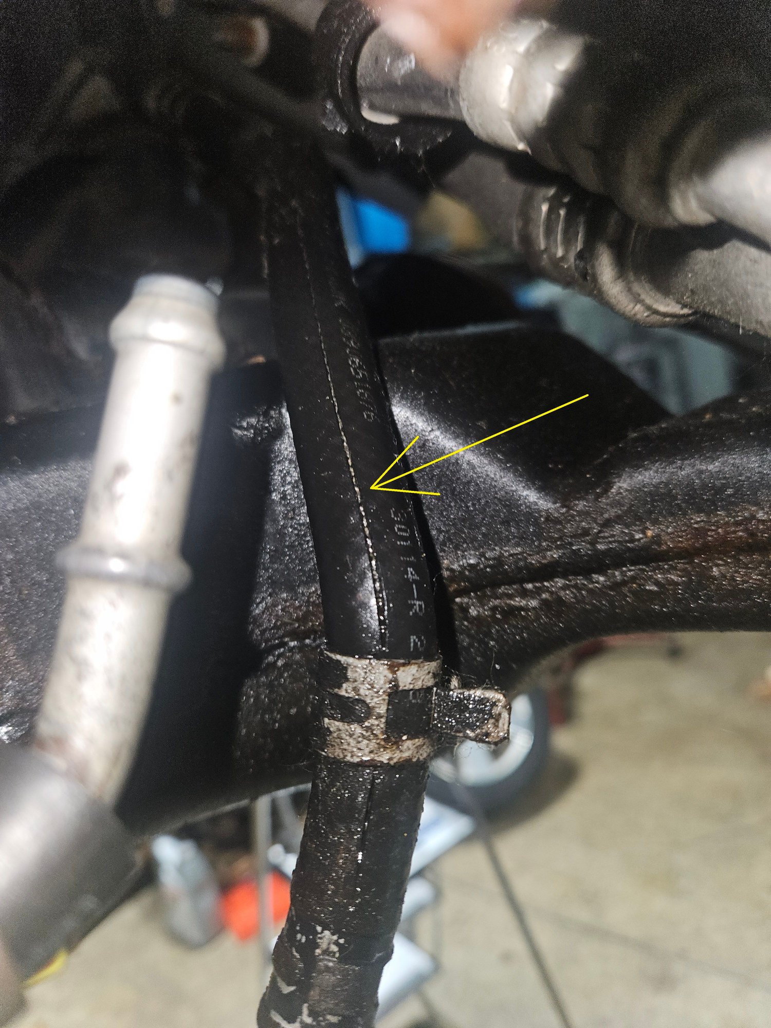

After a little disassembly and investigation, I found the source of the power steering fluid leak: there is a massive crack in the flexible portion of the power steering return line that runs from the steering rack out to the cooler loop at the front of the car. This hose runs along the back of passenger side of the engine bay, on the inside of the passenger fender well.

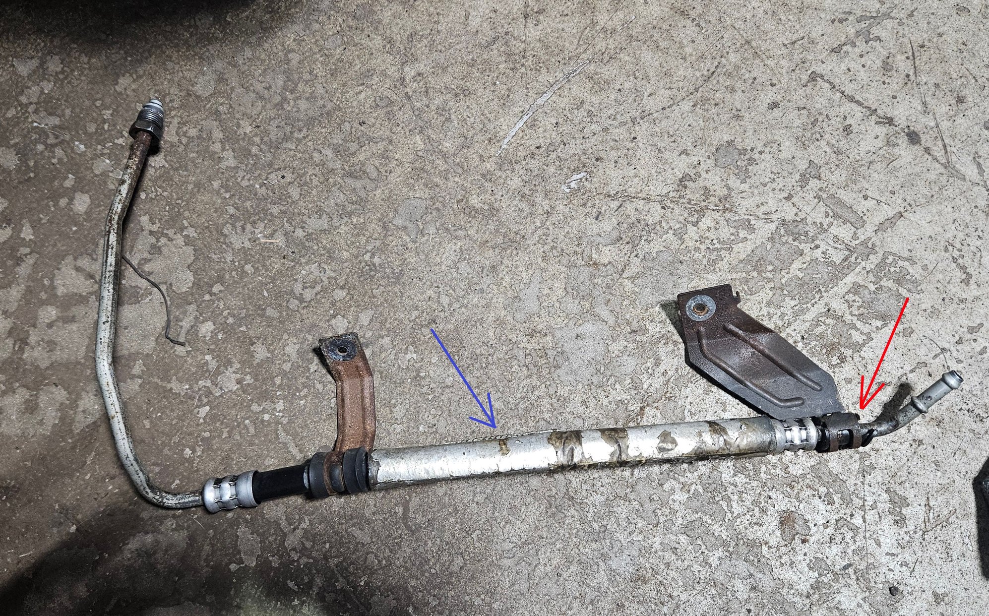

I've ordered the replacement cooler line loop (this goes from the passenger side of the rear of the front subframe, out to the PS cooler loop, and back to the PS reservoir), as well as a new PS reservoir (since the current, original one looks very aged/yellowed). I had already ordered the PS pressure line that runs from the pump to the steering rack, so I replaced that as well - the original line had not failed, BTW, and didn't show any leaks. Then I removed and rehabbed the first short section (pic below) of the PS return line path that goes from the steering rack to behind the front subframe (the isolation bushing/sleeve on one of its mounts was worn (red arrow, below), so I used some appropriately-sized fuel line hose to replace it in the clamp).
I'm going to find another of these protective sleeves (blue arrow, above) at the local U-pull yard to cover the new flexible hose in the PS return path (to cover the area where the old hose split) as an additional protective measure - against heat and road debris - when I install it.
