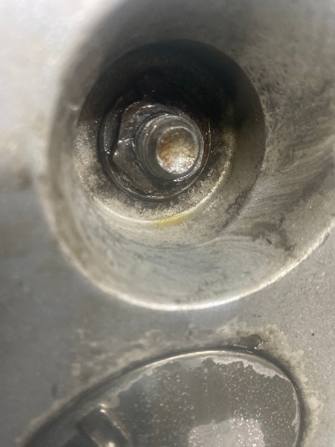

Removing my lug nuts yesterday and this one sheared off, leaving just a sliver of the lug nut and the angled shoulder still holding the rim onto the stud. Anyone have any ideas how to remove this??

Tighten down the other four lugs to spec. Then see if you can't get on there with a six point socket.... (doesn't look like it though....) Otherwise, drill out the lug stud......

Thanks. That’s what I ended up doing. Took a while but I eventually got it off.
