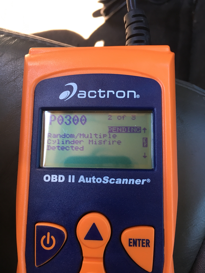

The car posted two codes.
CPS sensor and a miss fire. Hmmm
Looks easy enough to replace but is it actually the problem? I don't have starting issues.
Thoughts?

Actually yes, in fact the misfire may have been cause by the crank sensor. Start with the crank sensor, clear the codes then see if the misfire is still there. If it is, then you either have a coil going or one or both of the plugs in that cylinder are done. If the CPS doesn't clear the misfire, swap the coil with another one to see if the problem migrates.

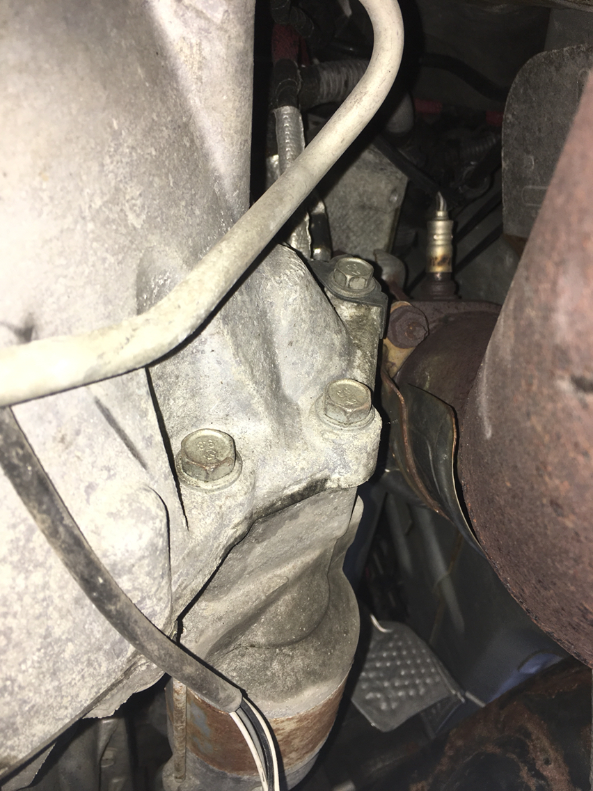

Thanks. Just bought the last CPS in Indy. Supposedly the part is on back order.
PB sprayed the bolts and will pu the part on Tuesday.

Replaced CPS sensor. Pretty easy job except for removing the connector.
Connector had lock and a squeeze and pull connector.
Note.
Unlock, if hard to move use contact spray.
Squeeze rocker end then pull connect from the opposite side.
Problem was resolved. Thanks
