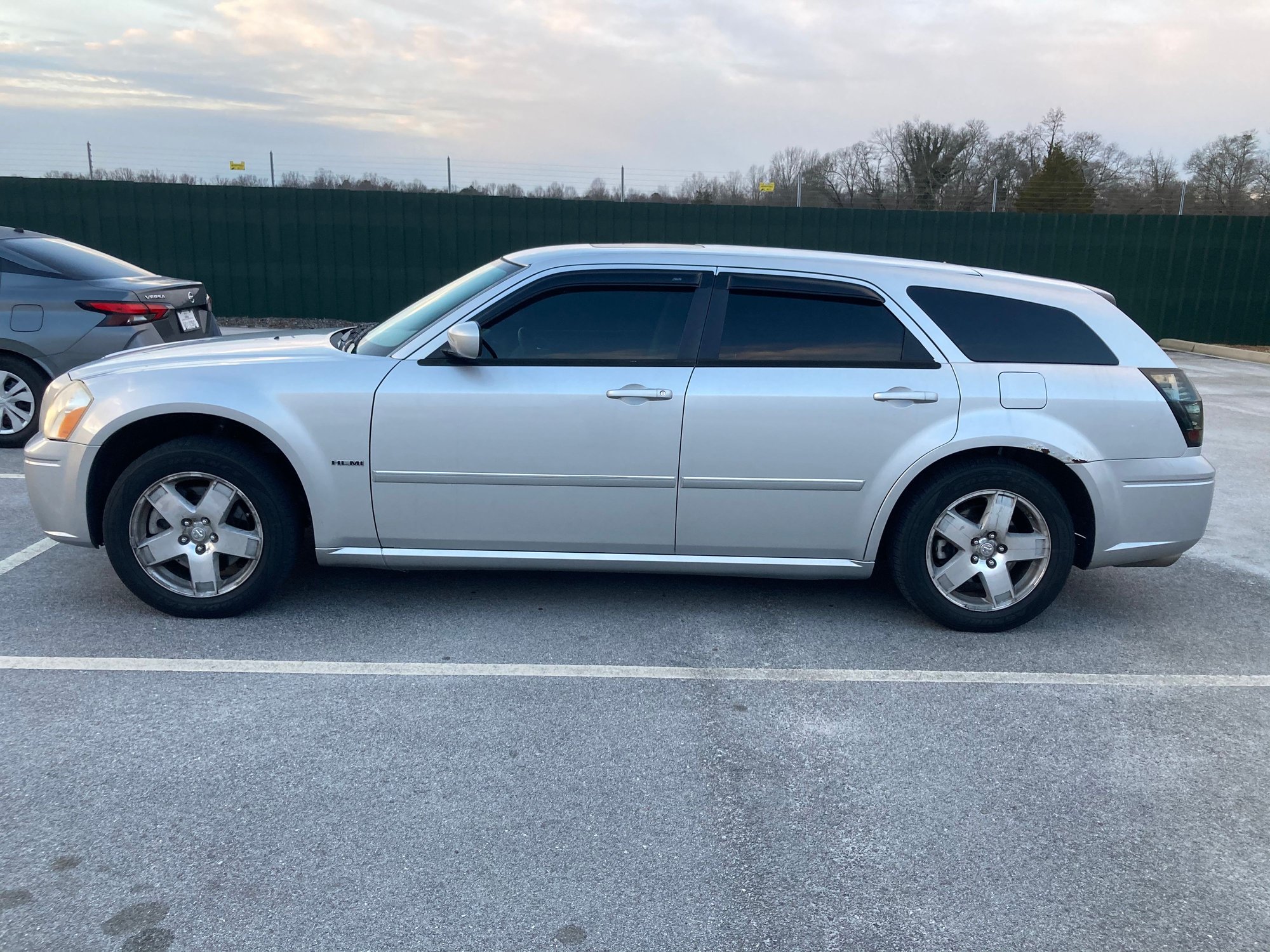

Hi all. Rebuilt entire front suspension with all new. Bought new struts as well. Car sits really high in front 32inches from ground to fender. Thought it was springs on the struts I bought. I Purchased a name brand spring and installed on the struts and it’s the same height. I replaced the rear springs and shocks and no issues. But the height in front makes the magnum look like a Carolina squat machine.
what did I do wrong? I regret not keeping the old parts, the struts matched the old exactly. Any suggestions? What other details did I miss in this post?

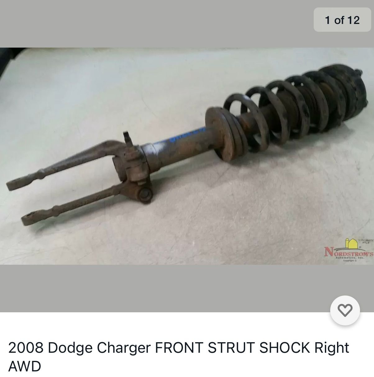

Looking at a bunch of used struts on eBay for reference, I noticed all the struts are about 7 coils. All I see new for my year are 9/10 coils on struts which might explain the stiffness. But if I look at newer charger AWD struts they are about the same 7 coil springs. So compatibility of chargers and magnums is the same correct?
