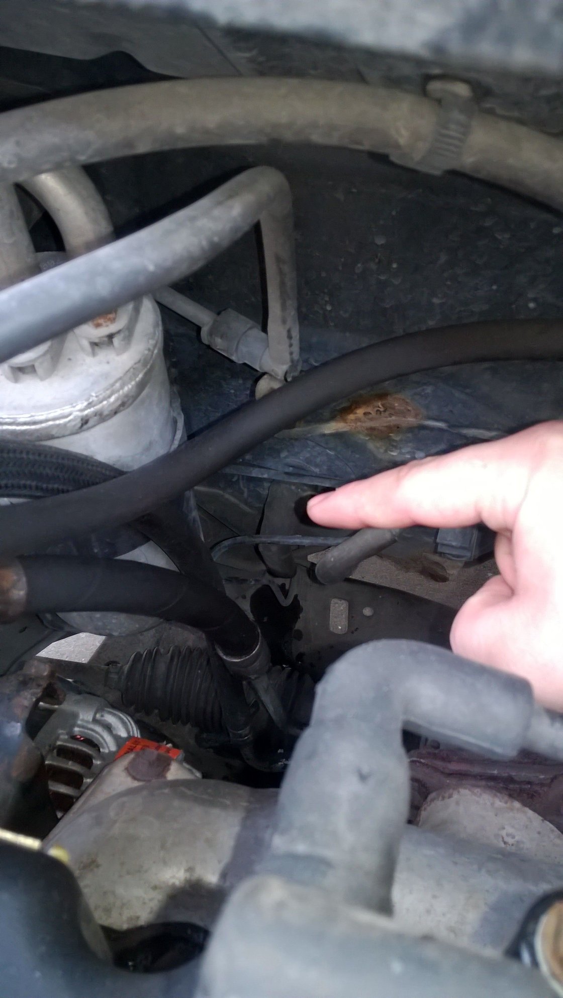

Ok so I found out it is coming from the back of the engine bay on the firewall. There seems to be a short hose that is on the passenger side that IT is leaking out of
My finger is right on the short hose. You can see the liquid below it

that 90* rubber elbow is the evaporator drain. if coolant is coming out of that spot; the heater core (which shares space in the hvac box with the evaporator) is leaking pretty bay.

Yep, that's a heater core leak.
