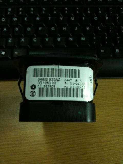

Hey, I'm new here and new to buying parts for cars. On the driver side of my Nitro the driver side window button broke. I took it apart and the plastic that gave it tension broke. Now I can't control the window. I've been trying to find a replacement part for the whole window/lock control but I can't find anything. Also I don't know exactly what I am looking for ie I don't know its name. If anyone could help me I would appreciate it. I've look through part after part on websites and had no luck.

I took a picture of the numbers on the piece. I have searched all of them and came up with nothing. Can someone please help.

that's the Master window switch, they should be like $35 from the dealership.
best bet is buy from dealership with VIN, because the early 07 has different switch from late build 07 an up.
