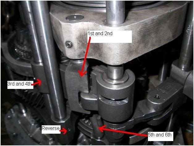

Look at the way the shift forks fit together, I didn’t do this and had to sit and figure that all out on my own. I put a picture that shows the important area to study. It actually makes a lot of sense if you sit and figure out how it works. The forks go in order, 1/2 on the outside 3/4 next followed by 5/6 with reverse on the inside.

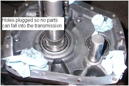

After you are done putting the bell housing back on you can stand it back up. I plugged all the holes to make sure that no parts could fall in if I accidentally dropped something.
