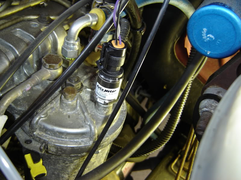

That IS kinda weird. I just screwed mine right into the fuel filter housing, however mine is an Autometer.
I'd double check with your gauge company to see if you can mount it like this.

Mayfair, It can be mounted like that if I got an aluminum billet cap for the fuel filter, but it would read pre-filter. I wish I could do it that way, but dodge redesigned the fuel filter housing in '03 (i think). Now it's plastic and has no top bolt to mount to. The extension tube idea was right from geno's garage, but autometer noted that the sender must not be attached directly to the block either. Anywho, I got it in today and it seems pretty good so far, I just put a tee reight below the sender and use the plug as a drain valve to fill the line.
