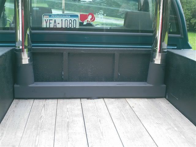

Here's how I did mine. A 4X4 tube witha 4" round into it. The stacks are 5" and the connectors are oblong. It works pretty good.

Ive seen the square tubeing/rectangular tubeing before. . .when you have two 5"stacks comeing out of a 4x4 tube at 90*, or a 6x2 rectangular tube with the same, the restriction is not as great as you think. however the abrupt change in direction does increase backpressure, that backpressure can lent itself to help low end torque
I've got a bunch of questions here ...
What's going on along the sidewalls?
Wood floor?
What kinda liner is that?
Got more pics?

My guess would be utility body.

yeah the box setup has been around for a while and as Drew eluded to it flows just as good as tubing
old idea new picture
