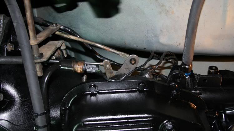

You in fact do have the A518 transmission. TransGo and Sonnax make kits for the valve-body that allow the typical tweaking including the Shift Command feature (allows downshifting to any gear at any speed and holding that gear).
The floor shifters commonly available will work just fine. Your column shifter is no doubt like mine was. There's a "Torque Lever" that basically connects the column linkage to the transmission's shift lever. It's seen in the left-hand side of this image. ~

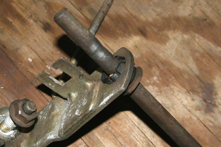

There's nylon bushings at each end of the shaft as well as a couple for the linkage ends. Mine were wallowed out. Further, my shaft was heavily worn where the transmission linkage connected. ~
