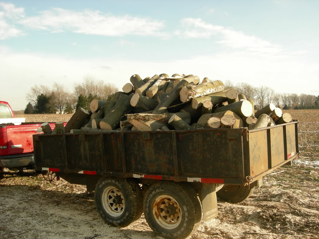

Gooseneck! If you plan on using it much and can justify the extra money. They pull much nicer. Don't have to worry about loading the tongue heavier so it doesn't sway. They don't try to turn the *** of the truck like bumper pulls. Back up nicer. Here's our raddy old Bri-Mar. It does all those things I mentioned but it still dumps good.
