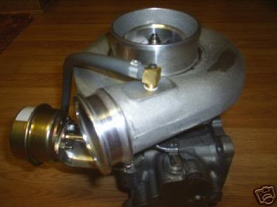

does anyone have a pic of it installed?

i see how it fits to my 05 it has a rubber line that would be simple to install, but my 01 ther is a steel tube that goes into the turbo housing bout 1/2 inch any other ideas??

bigoilwhore's Avatar
bigoilwhore
Posts: 17
Default RE: Turbo mod?
http://i84.photobucket.com/albums/k3...boostelbow.jpg
here is a pic of one in stalled
Well done !!
