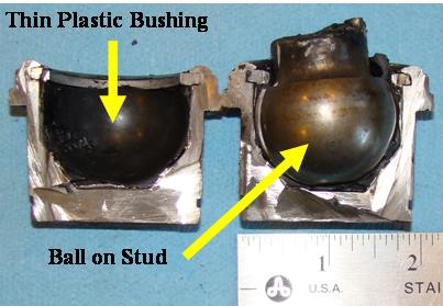

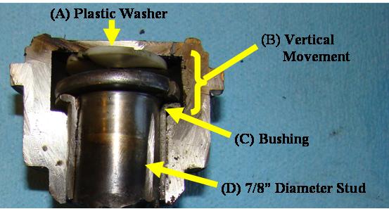

Hey guys my boy and I replaced all the ball joints on his 2003,3500 truck and I cut the old ones in half and this is what I found. The upper ball joint is designed to have upward movement.
