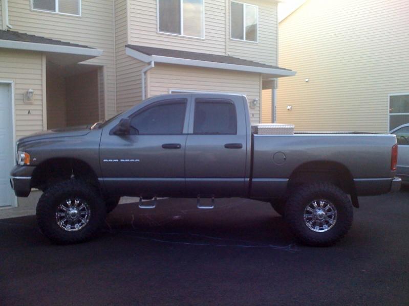

I can send you one tomorrow of a buddies freshly done 05 with a 6" and 37", be warned that running 37"s you'll be limited somewhat by the rims you have to pick from, most rims will either rub on the rear of the wheel well or on the control arms. I went with a Superlift 6" and 37"s and my freshly painted to match fender flares where chipped within days from the tires hitting them. I now have 9" of lift just to clear the 37" when I’m off road.

I currently have the Coopers on my truck, I have about 50% tread left and just found out that one of the tires is .045 out of round, apparently this is common with Coopers and that's why they are less money than BFG's and others of the same size.....I liked how they worked in the sand for me, but never could get them to ride or sound right and now i know why. If you can afford them i would suggest BFG M/T's, i had them before my Coopers and got about 50,000 miles out of them.
Here's the picture i mentioned, let me know if it loads...First time posting a picture on this site.

Looks good, so those are 37's on a 6 " lift right?
