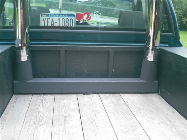

Heres mine, 4"X4" crossover into 5" stacks. I crushed one end of the short 5" pipe in a vise to oval it to fit the 4" crossover. You can also get a 4"-5" reducer. Underneath I used a 90* and a 45* to come up to the center, and a short flex to connect it and allow for movement.
Painted it with grill paint.
