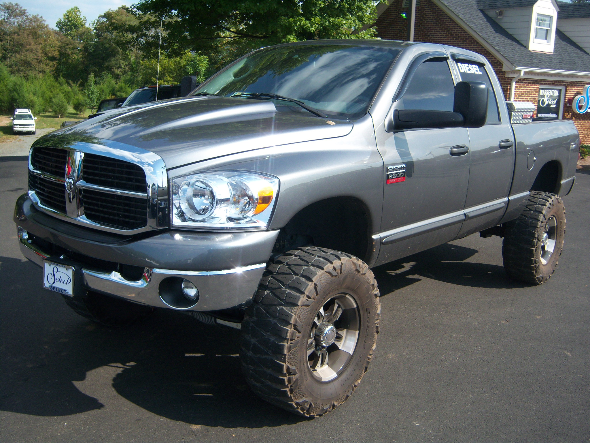

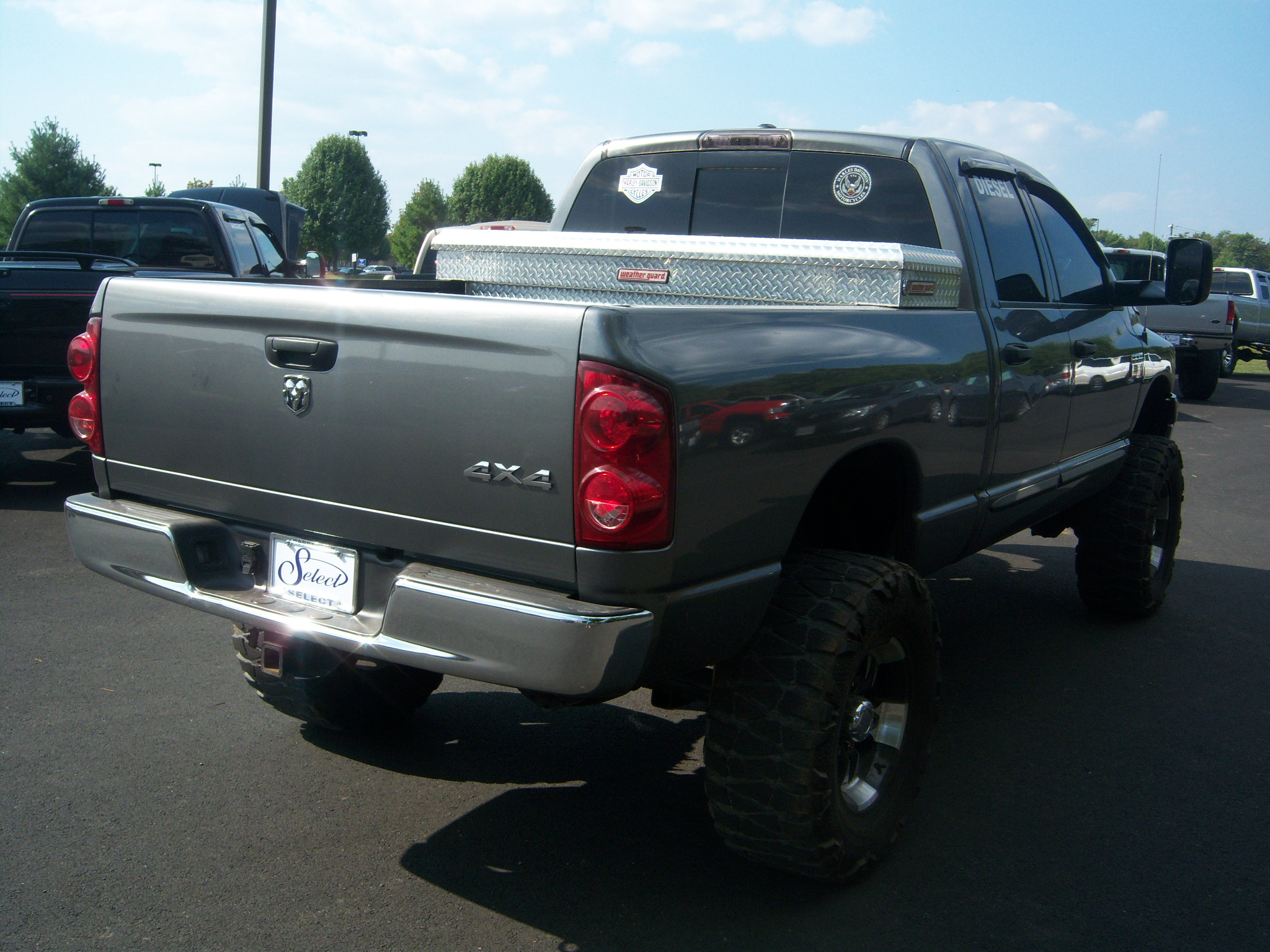

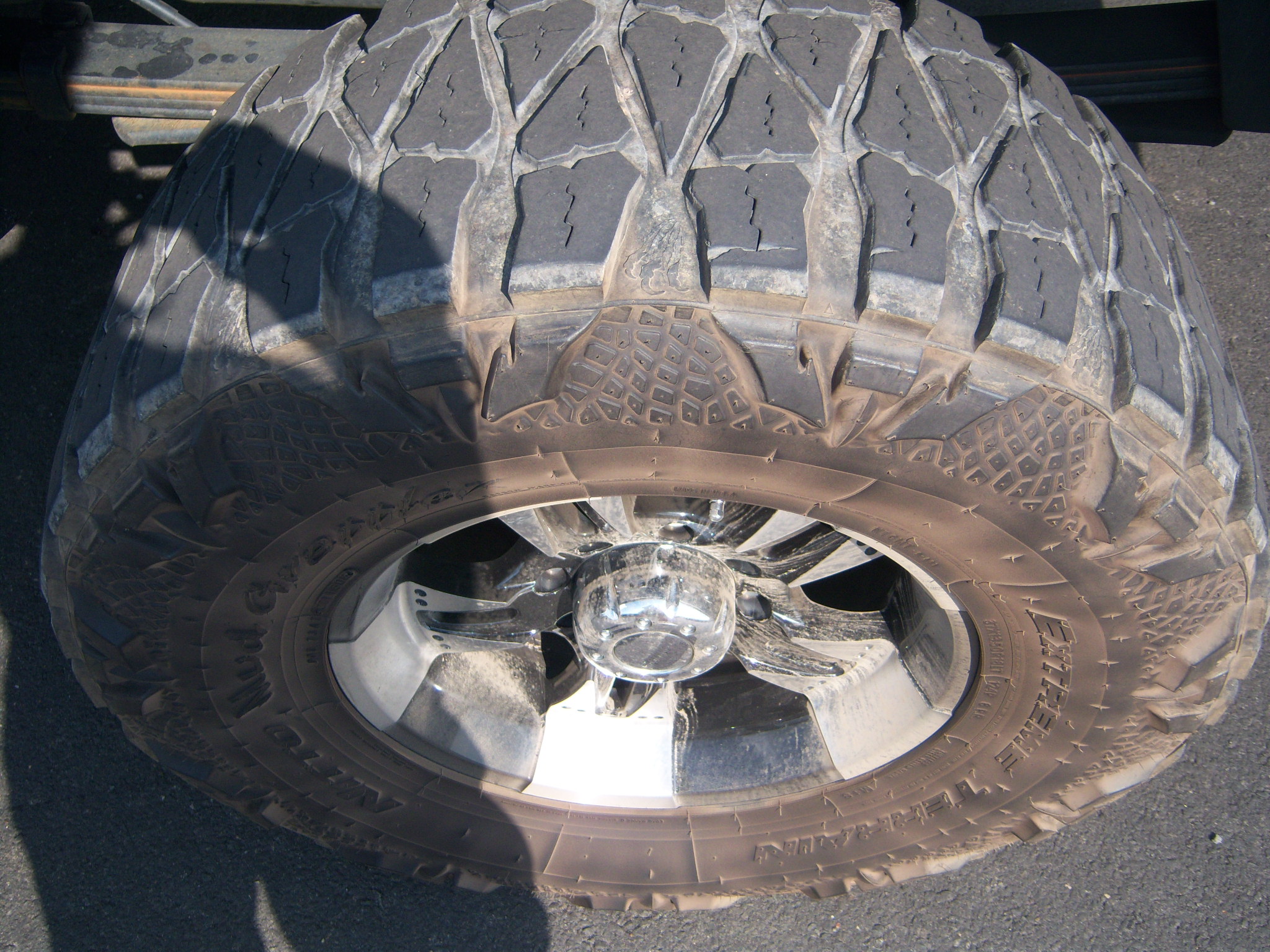

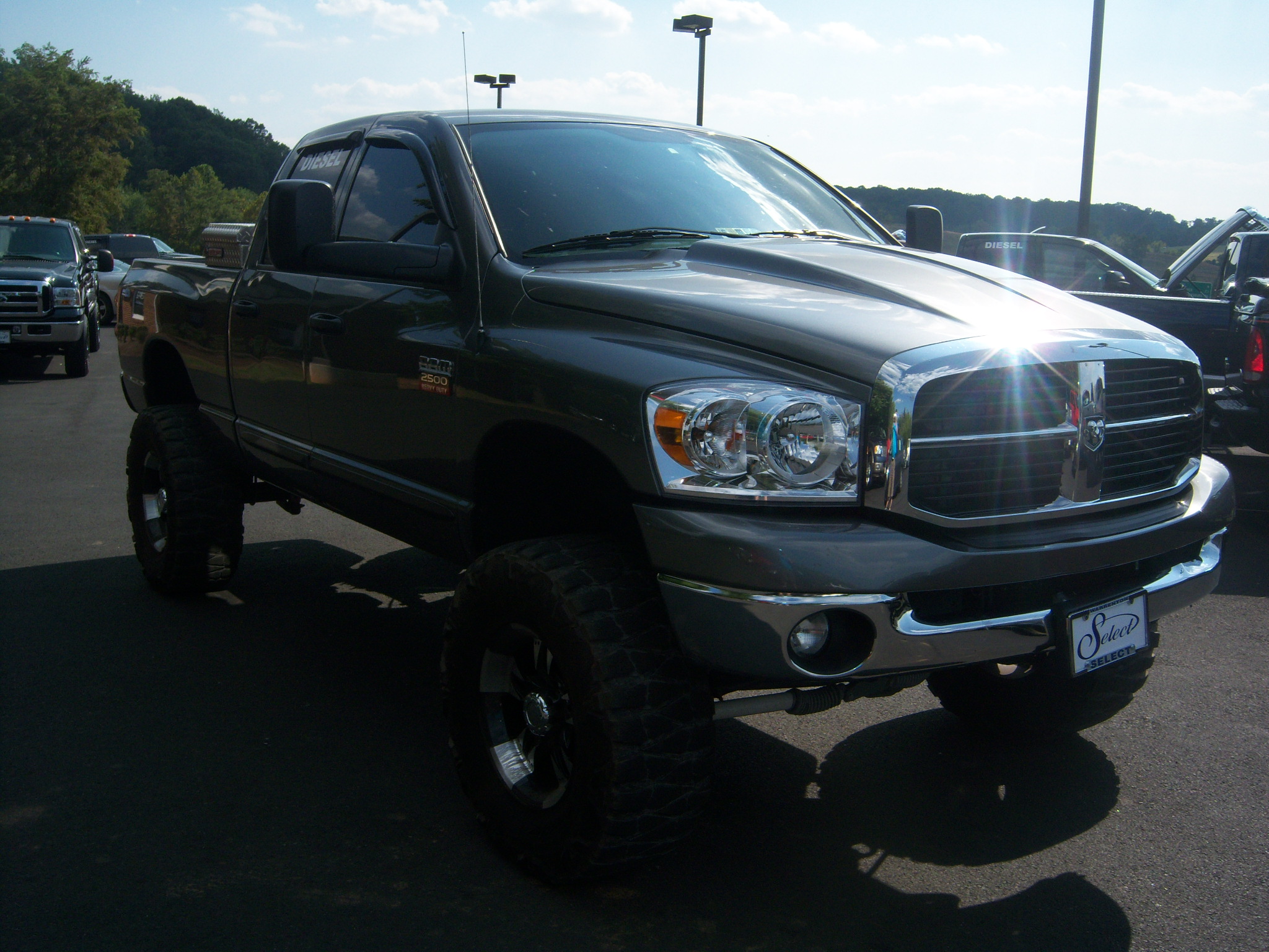

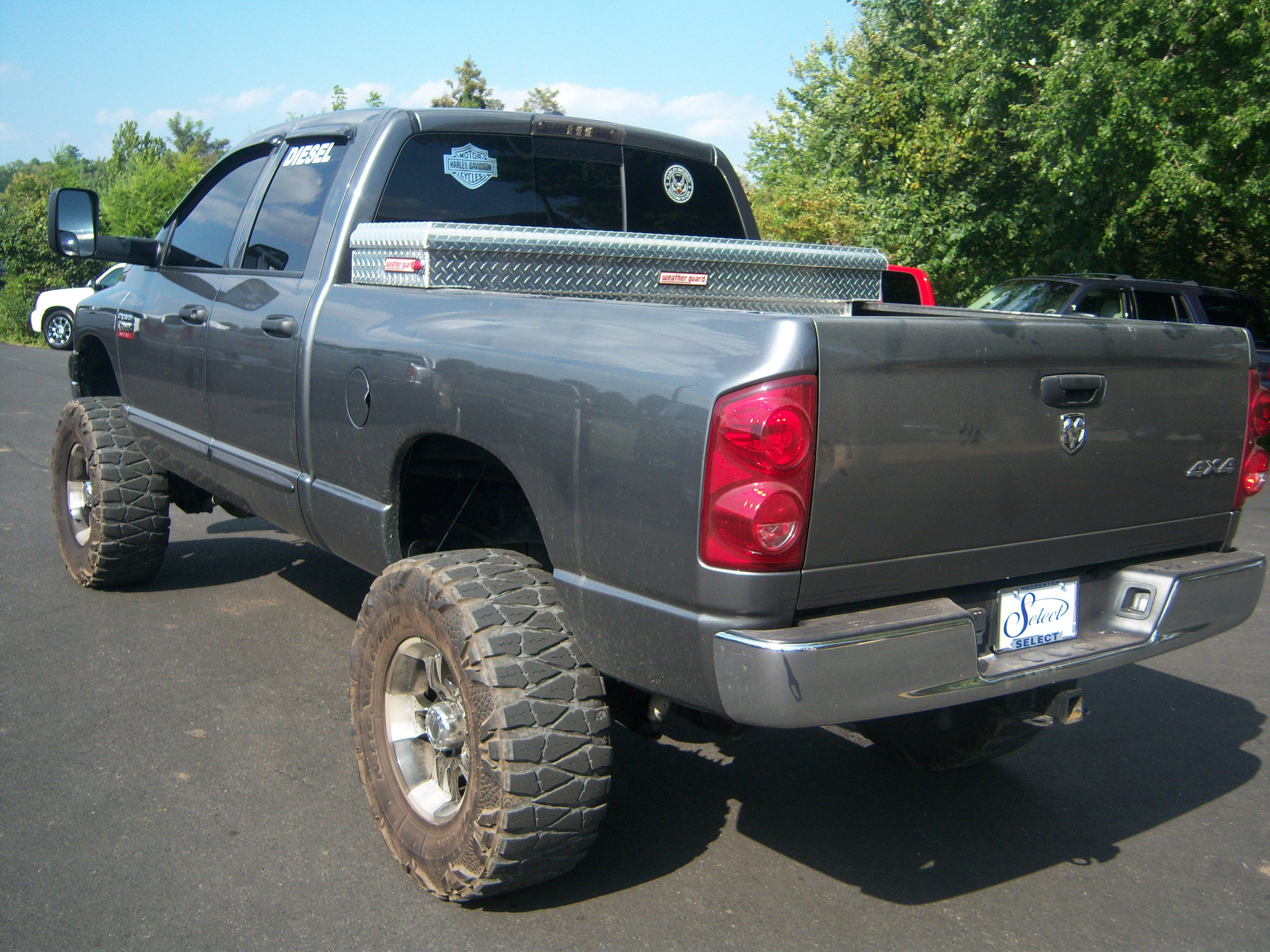

Here are some exterior pics of the one I am looking at that made me need to make this post (ignore the 'DIESEL' stickers, this dealership puts those one so people can tell at a glance, Oh and it's dirty because it was just traded in and not detailed yet)...
http://www.pszweb.com/truck/Ram%2025...h/101_3711.JPG
http://www.pszweb.com/truck/Ram%2025...h/101_3716.JPG
http://www.pszweb.com/truck/Ram%2025...h/101_3717.JPG
http://www.pszweb.com/truck/Ram%2025...h/101_3718.JPG
http://www.pszweb.com/truck/Ram%2025...h/101_3719.JPG

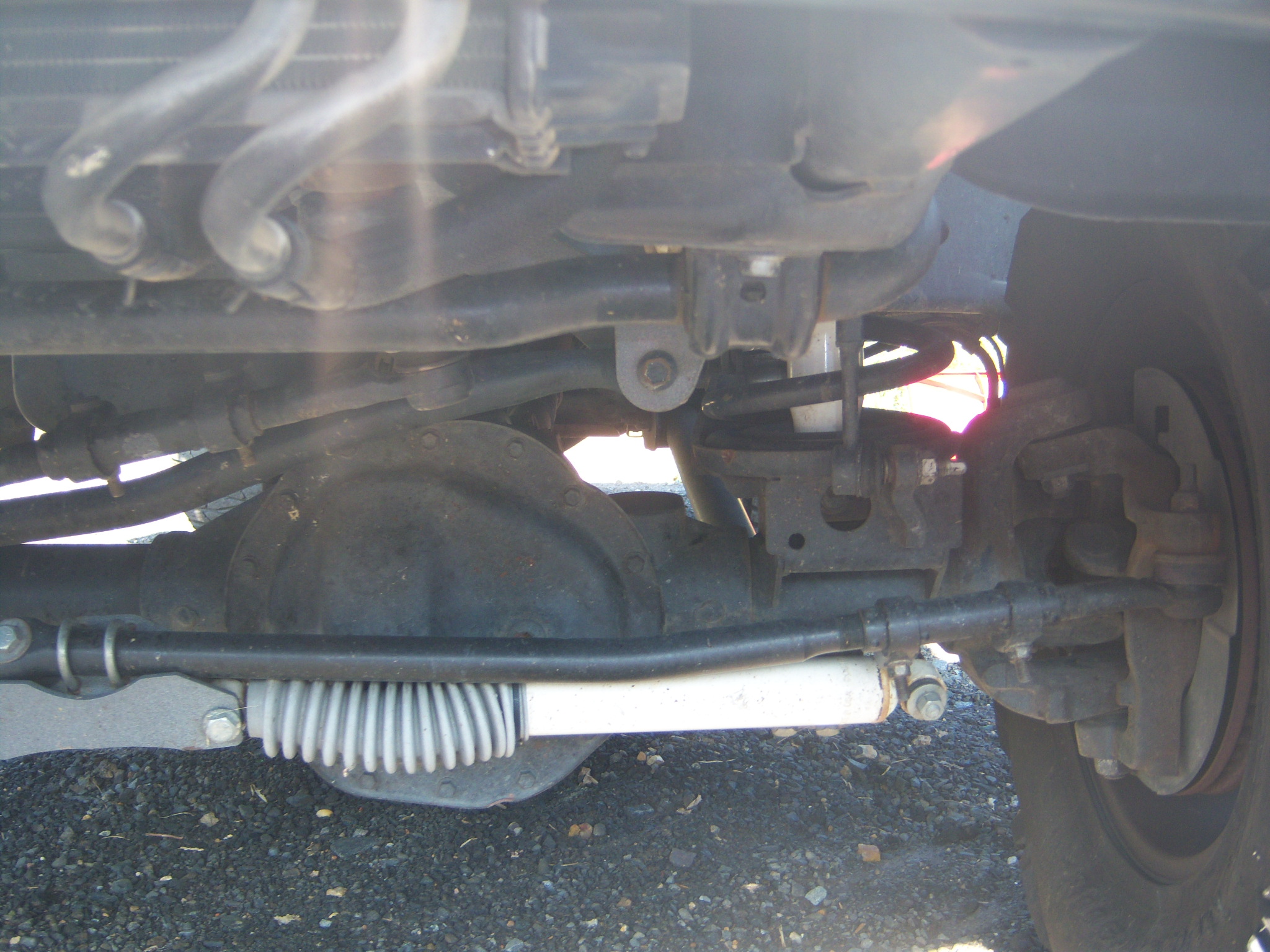

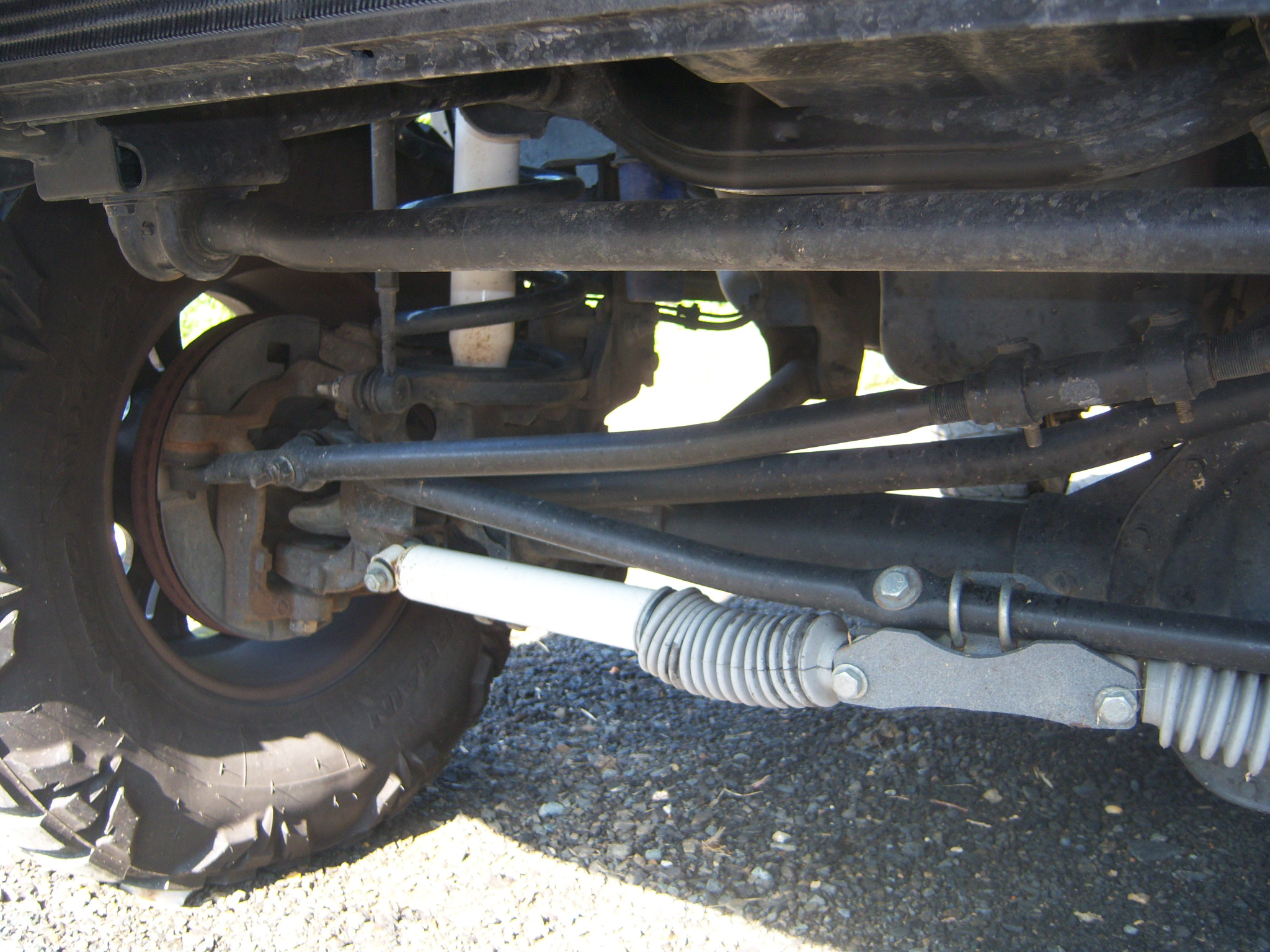

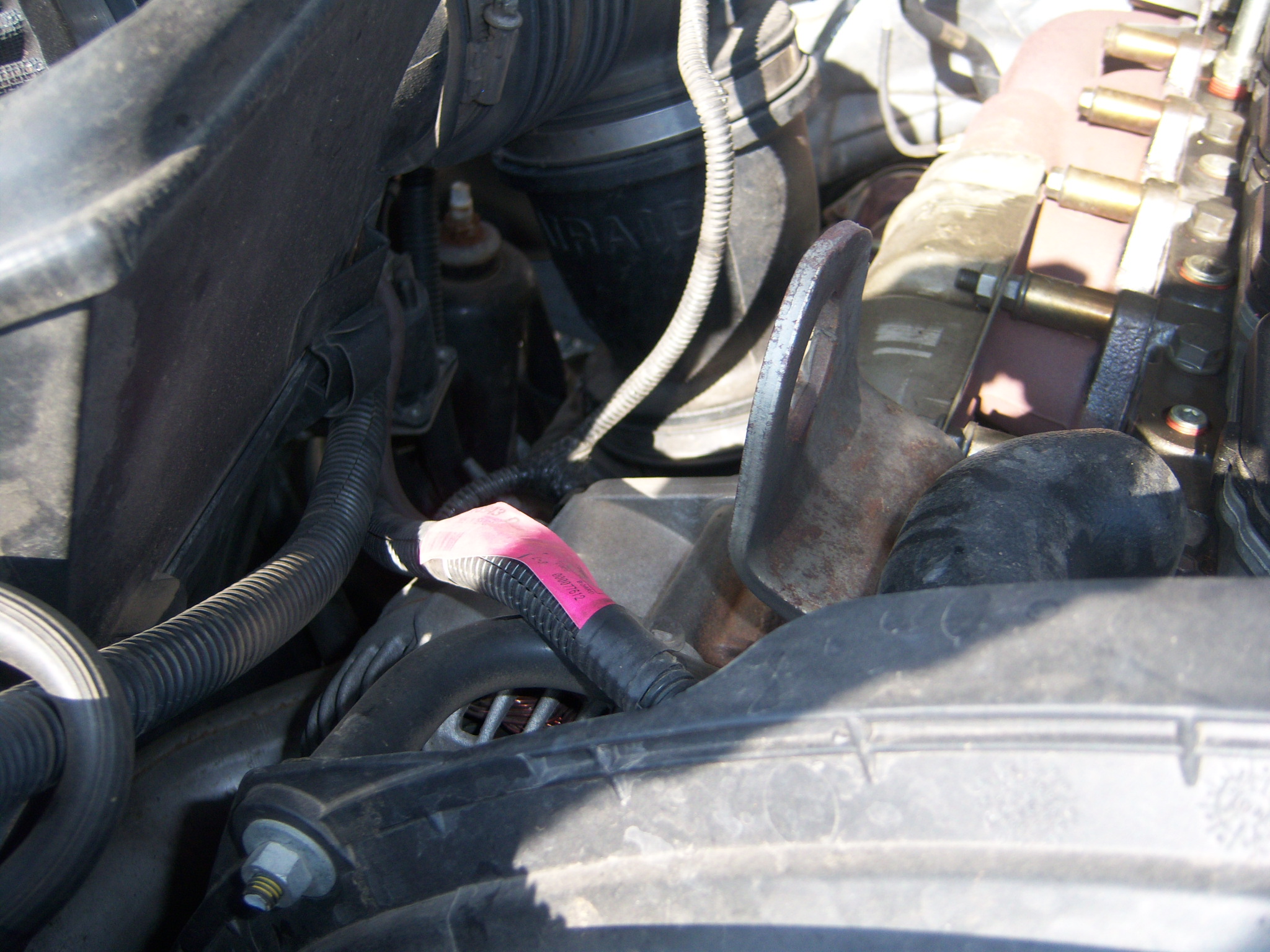

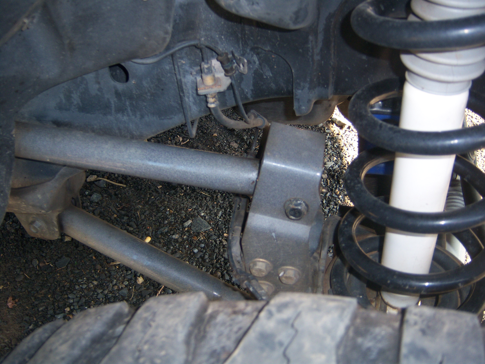

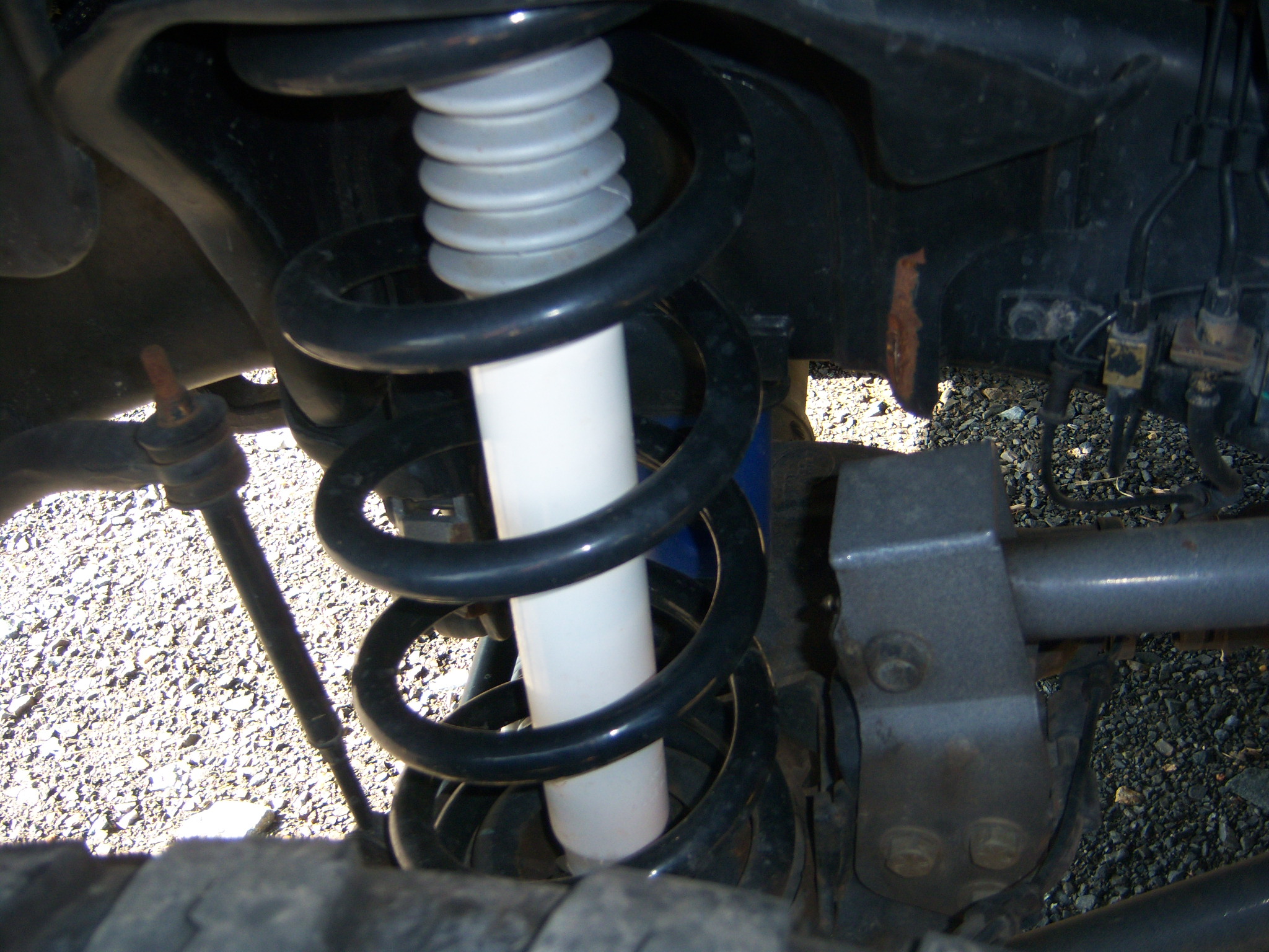

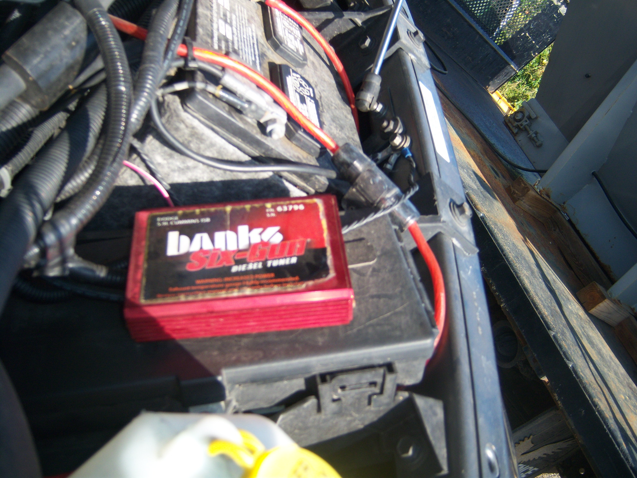

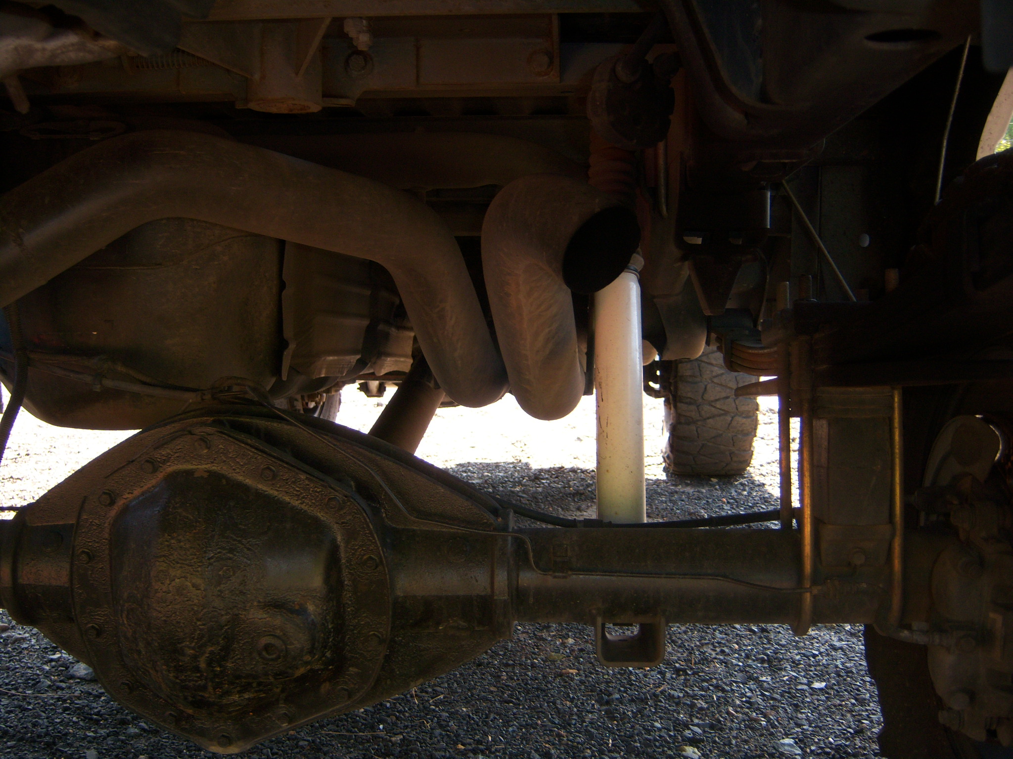

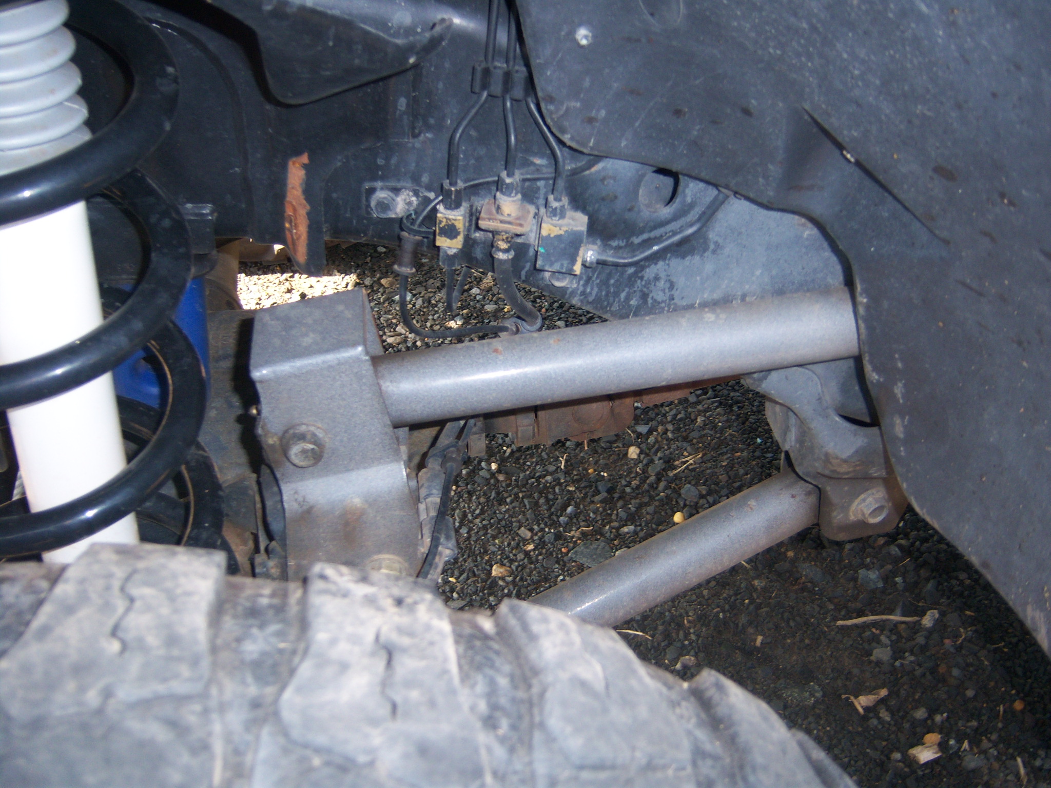

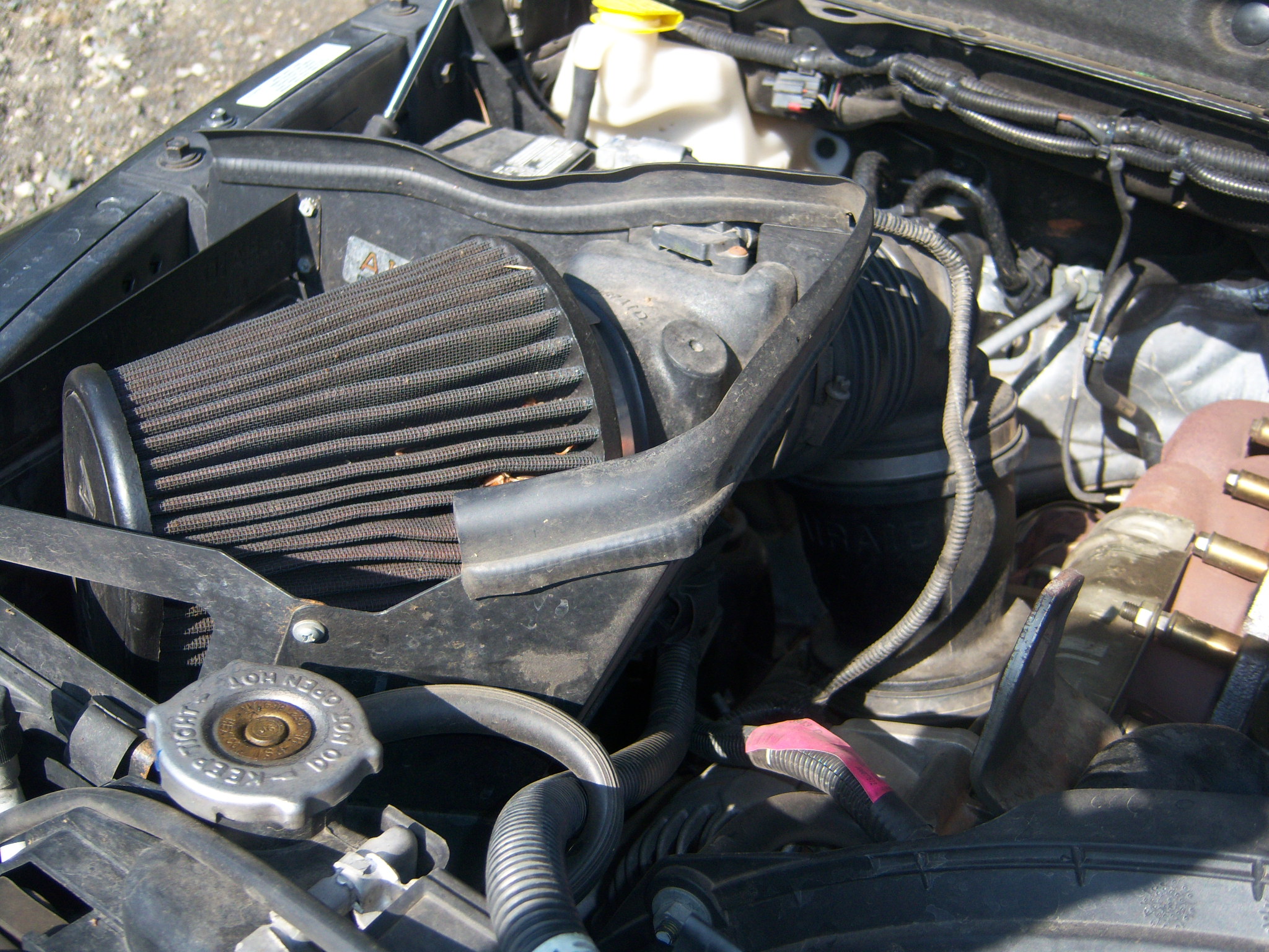

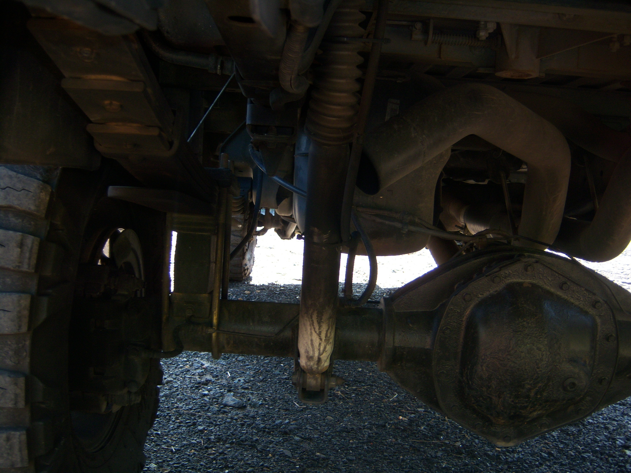

OK, I just got some more info from the dealership working on this, they said they said it is over at their shop getting some work done before it hits the lot for sale because they need to inspect it and all that and found they need to put exhaust on it. They also said it was a BDS lift kit, and the guy working at the shop they use for thier diesels did the work on this truck and knows the PO, so I will be calling that guy a little later (the line was busy when I last called).
I asked them for pics from under the truck and under the hood and this is what they sent:
http://www.pszweb.com/truck/Ram%2025...h/101_3795.jpg
http://www.pszweb.com/truck/Ram%2025...h/101_3796.jpg
http://www.pszweb.com/truck/Ram%2025...h/101_3797.jpg
http://www.pszweb.com/truck/Ram%2025...h/101_3798.jpg
http://www.pszweb.com/truck/Ram%2025...h/101_3799.jpg
http://www.pszweb.com/truck/Ram%2025...h/101_3800.jpg
http://www.pszweb.com/truck/Ram%2025...h/101_3801.jpg
http://www.pszweb.com/truck/Ram%2025...h/101_3802.jpg
http://www.pszweb.com/truck/Ram%2025...h/101_3803.jpg
http://www.pszweb.com/truck/Ram%2025...h/101_3804.jpg
http://www.pszweb.com/truck/Ram%2025...h/101_3805.jpg
So looking at the BDS web site this looks like their 5" rear block lift setup, but if anyone out there is more familiar please let me know, and also let me know your thoughts on towing with this kit.

Alright, I just got off a pretty long call fromthe local truck accessory shop that did most of the work on that truck, it sounds pretty promising. The PO was a younger guy (25-26 yo)in a decent job (local power company), he maintained the truck pretty well but got down on his luck and needed money so traded it in with all the goddies, there is an airraid CAI, Banks 6 gun and PDA, the BDS lift, and 18" wheels and 37" tires. From the shop it sounded like the guy was the ype to "do it right" and save up for something and get it done right the first time, and he took good care of it. He said that it's a small town and he is the only accessory shop, so he knows most of the trucks in the area and told me storries about some of the ones that are just abused vs this one that he said he has been telling all his buddies to look at. I kinda asked him to stop doing that because I don't want it sold before I get down there, lol...
The shop that did the lift said they have done many and have a good reputation in the area, it has been on the truck for over 2 years without issue. At least as stated by the shop guy I spoke with earlier today. But my understanding of the death wobble is that it is easily correctable, just scary as hell when it happens, and just park the truck and order the parts, or am I wrong?

I've been searching for used Dodge Ram 3500 for what seems like forever (I'm really particular about what I want). I currently tow about a 9k lb travel trailer, and I also love lifted trucks. I think the Dodge looks best with 37x13.5x17s (sorry, I don't like the Dubs on 4x4s). Anyway, I'm just trying to qualify myself as having browsed hundreds of these trucks in various states of lift.
Looking at your pics, it almost looks like the lift is only 4"? I say that because there doesn't see to be as much clearance btw fenders and tires as I'm used to seeing with a 6" lift and 37" tire combo. Also, the tires seem to stick out quite a bit (yes, even for being 13.5" wide). This might be an issue of not having quite the right offset. Personnally, from a visual perspective, I think the wheels and tires should be tucked in tighter. But the important thing for you is to check to make sure that a different offset won't affect the structural integrity, especially when towing. If not, then as I said it is just a matter of preference.

Thanks for the feedback Vince, but I picked that truck up yesterday, yes I agree that I do not like the way the wheels/tires stick out, but it tracks fine, feels great on the road (4 + hour trip in it yesterday) and the previous owner towed with it in this configuration and said it did a good job and was actually more stable. I would tend to agree as both during my test drive and the drive home after buying it I hit some clover leaf style on ramps and exits without feeling anything off and it felt better then the 3500 6spd that I also test drove.
As for the lift, I trust them when they say 6" and that is what the shop who did the install told me too, and when I stand next to the truck at the rear I have to tippy toe to look into the bed and I am 5'11" and the same goes for under the hood, steping up into the truck was a real stretch until I took the step bars off my 1500 and put them on this truck right there in the lot at the dealership, I couls then at least get a foot on them and wasn't hopping up into the truck...
