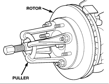

Here's the easiest thing you can do.
You'll need a puller, but removing them both is no big deal..............as long as the bearing isn't frozen to the stub shaft....

thank you very much for the diagram. i dont have a lot of tools, especially not a puller so I'll do what i did when I replaced the wheel bearing on hte opposite side....i'll pull the whole axle, pound out the lug bolts, then drop the rotor on the ground til the bearings come out. buuut, if my paycheck is big enough this week i'll just replace both the rotor and wheel bearings since i have 230,000-ish miles on my truck, it probably needs replaced anyway lol.
thanks for all the help guys

If you can't get a puller, another thing you can do is get a new set of wheel bearing bolts or 4 bolts the same thread and cut a grove in the top of the bolt head so a flat blade screw drive fits it. Screw those in a few threads on all four bolt holes, then just use a air hammer or a regular hammer on the bolts with the groove cut in them. When you get the bearing loose you can use a screwdriver and pull the bolts out and then pull your axle out of the bearing. You should be able to get it out that way too, I use to do it that way untill I bought a puller.
