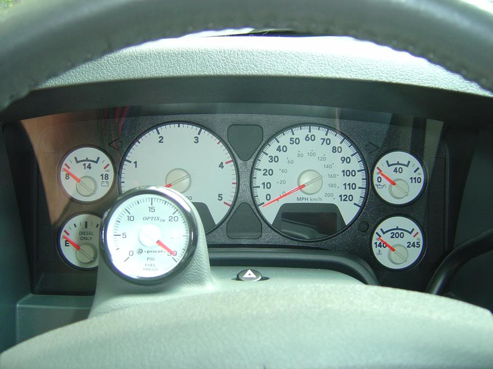

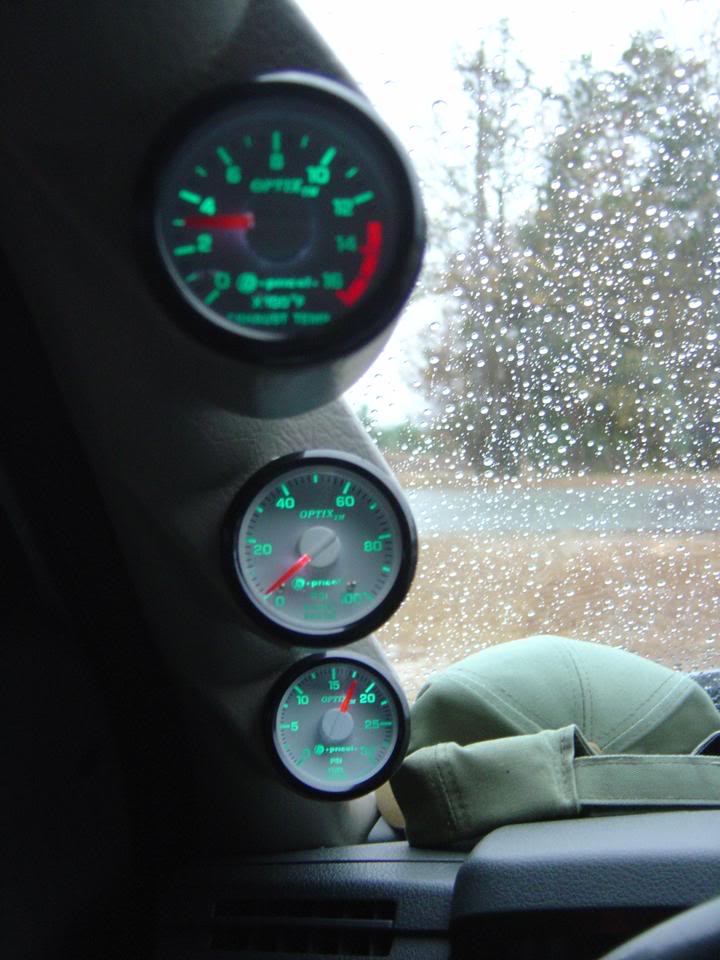

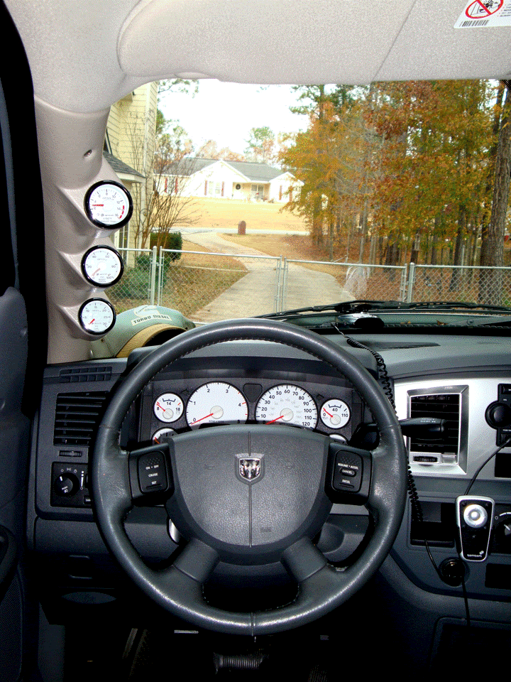

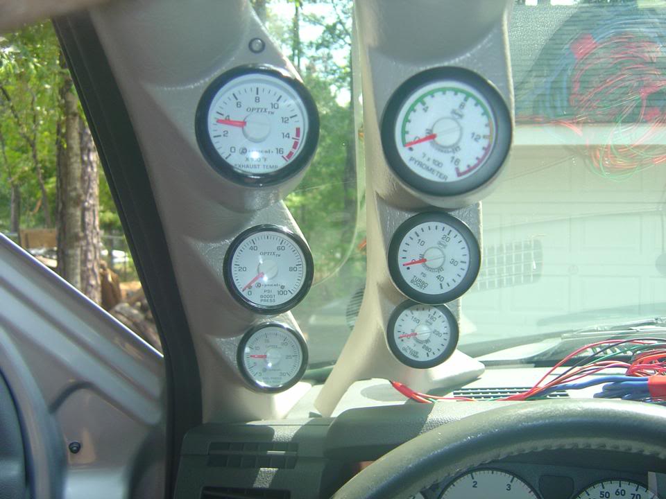

Pat,
As far as gauges, the two that match the stock interior best on the 3rd Gen's are DiPricol and Isspro.
Here's a set of each to compare.
The DiPricols are what's installed on my truck and the Isspro's are the ones I'm holding up next to them.

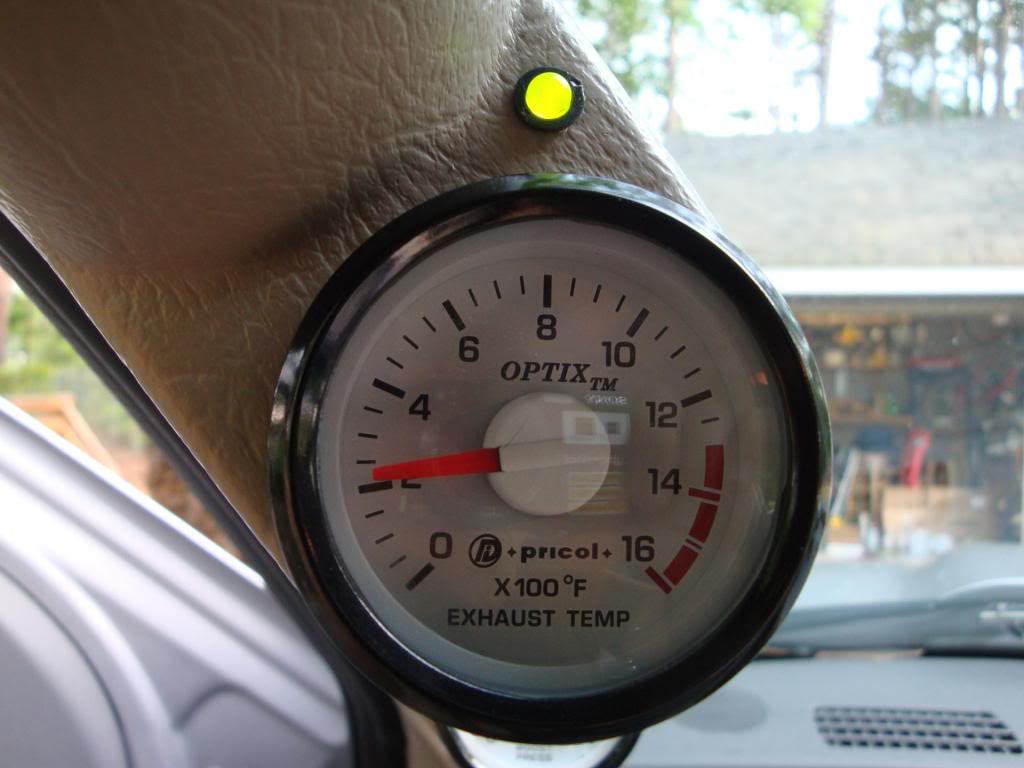

That LED gives me a visual indicator of the EGT's.
It stays green until 800*, then it turns yellow.
At 1000* it turns orange.
At 1250* it turns red.
I have it setup with the water / meth injection.
The first shot fires at 800* and at least 15 psi, the second fires at 1000* and at least 25 psi and the third shot fires at 1250* and at least 35 psi.

Okay so here is my real questions
How does that work It works off the water/methane system?
Or is it tied into your Gauge?
I said something like that to myself I wish that had a light to tell me the EGT was High.

The LED is tied to the water and meth.
I only turn that on when I'm horsing around or at the track.
It doesn't do jack for HP, I saw 738 without water / meth and 742 with it.
I'm pushing enough fuel that the only thing the water and meth does is cool the air charge.
