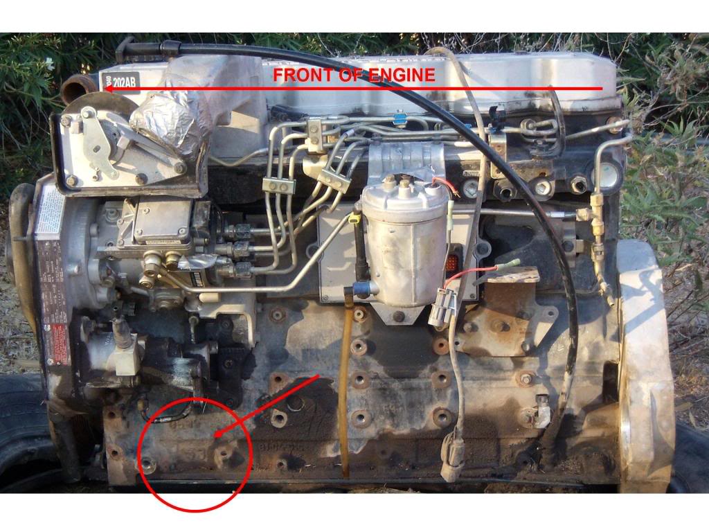

With it being a manual, you pretty much mentioned the stuff to check.
The only other thing to be wary of is the "53" block.
There is a casting number on both the driver and passenger side. The blocks cast with 53 in them are known to be weak castings and the water jacket tends to crack when heavy mods are thrown at it. Not all, but a much higher number than any other casting.

Coal Train hit the nail on the head. The big thing to look for is the 53 block..

good tip, so we should stay away from a 53? but isn't hard to see this in the engine bay? is it easier to see from the bottom?
Old Jan 31, 2010 | 03:03 PM
Coal Train's Avatar
Coal Train
Posts: 863
From: East Alabama
Yes, if you can avoid it, stay away from the 53 block.
Easiest way to see it is from underneath the truck with a flashlight.

What years was the 53 block used?
Old Feb 2, 2010 | 07:19 PM
Coal Train's Avatar
Coal Train
Posts: 863
From: East Alabama
You find them between '99 - '01.
Mostly '99 and '00
