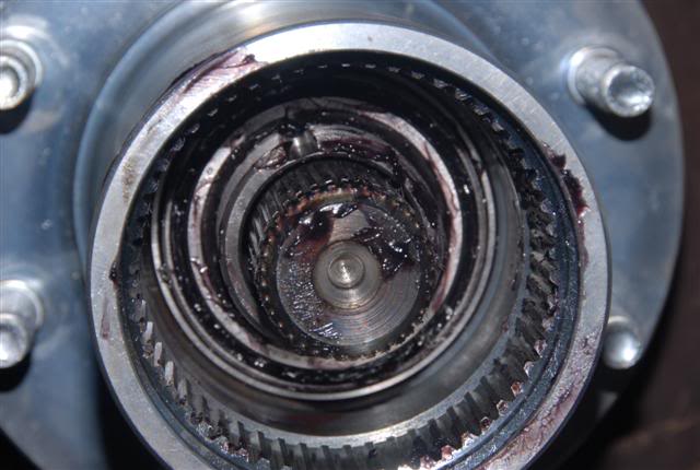

32) have a look at these 3 pictures... when you assemble the locker into the hub, it will only go 1 way. with the control in the "Free" position, the end of the spring needs to mate up to the bottom of the "tooth" such that when it is rotated to the "Lock" position, it does not slip off the end... if it does, it will not unlock and it will jam.
33) Next slide the lockout body into the hub, you may need to rotate it some to get it to line up.
