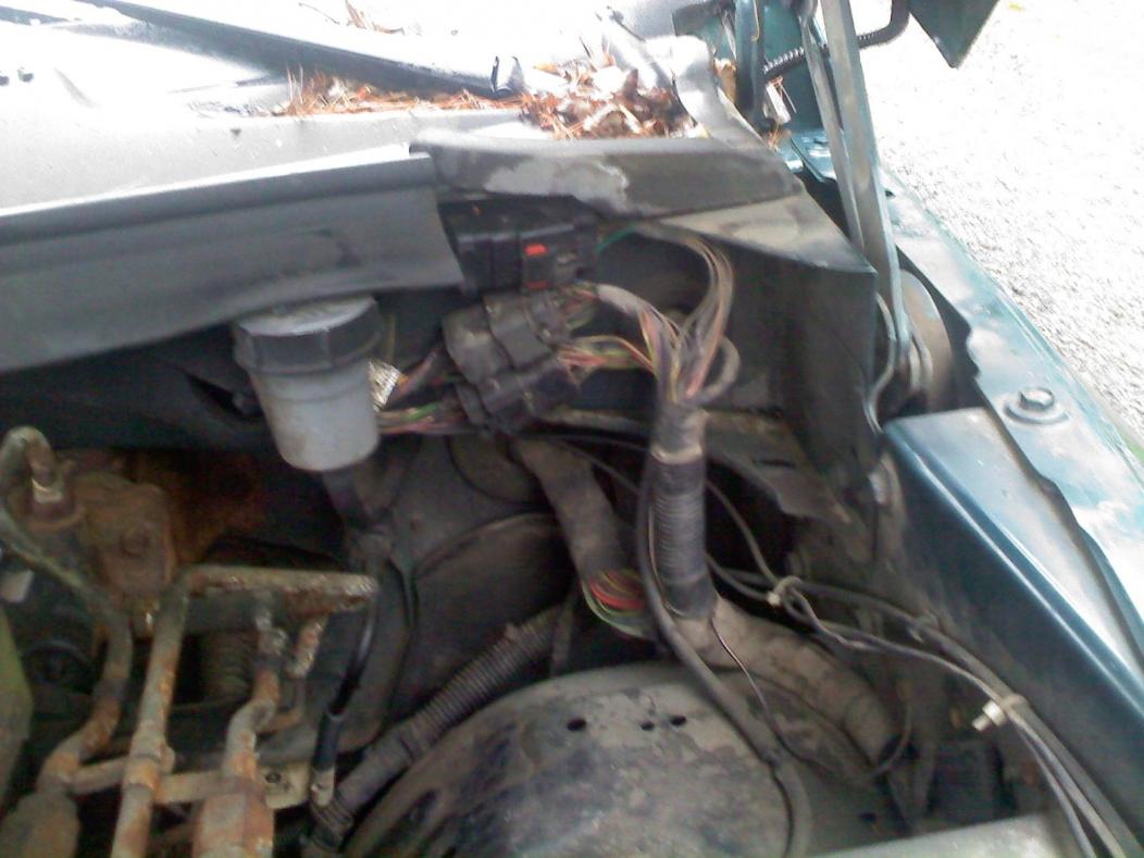

I have a 1998 Ram that I am swapping a Cummins into. I'm working on my wiring and there are three or four larger connectors that are right between the ABS control and the firewall. Anybody know where they go?

This is a pic from my friend's truck. Unfortunately I didn't have time to trace wires on his.

Well my friend's is a '97 and his are all hooked to something. Also, at the moment I'm not getting power to the starter from the ignition switch. I tested the circuit and the starter solenoid, relay, and relay circuit are all ok. I traced the black/white wire from the ground terminal on the starter relay and it goes to one of those plugs. Also, there are two wires that go back to the transmission that I believe are for the back-up lights, and I traced those back to one of the plugs.
