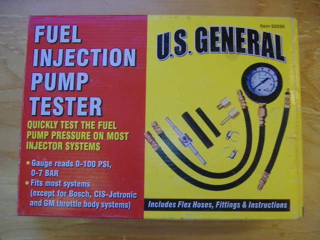

Make sure to check your fuel pressure at the VP-44 when you get your new pump, you want to see about 18psi at idle, and about 14psi at WOT.
Use something like this to test the fuel pressure.
