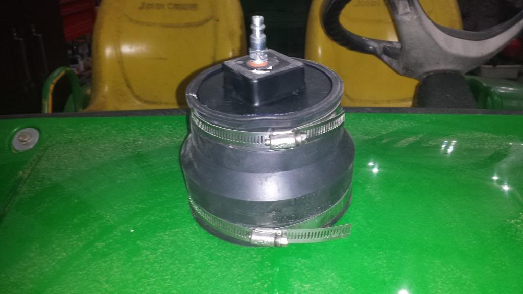

make one of these:
it's a rubber pipe reducer with a threaded pipe plug glued and clamped in the end. the threads bite into the rubber to help keep the plug in under pressure and the glue helps hold and seal it.
drill and tap the end and put a air hose fitting on there. then you can set your air regulator down to say 10psi and pressurize your intake at the turbo to check the system for leaks with the truck off.. cost me about $13 at home depot to make that...
