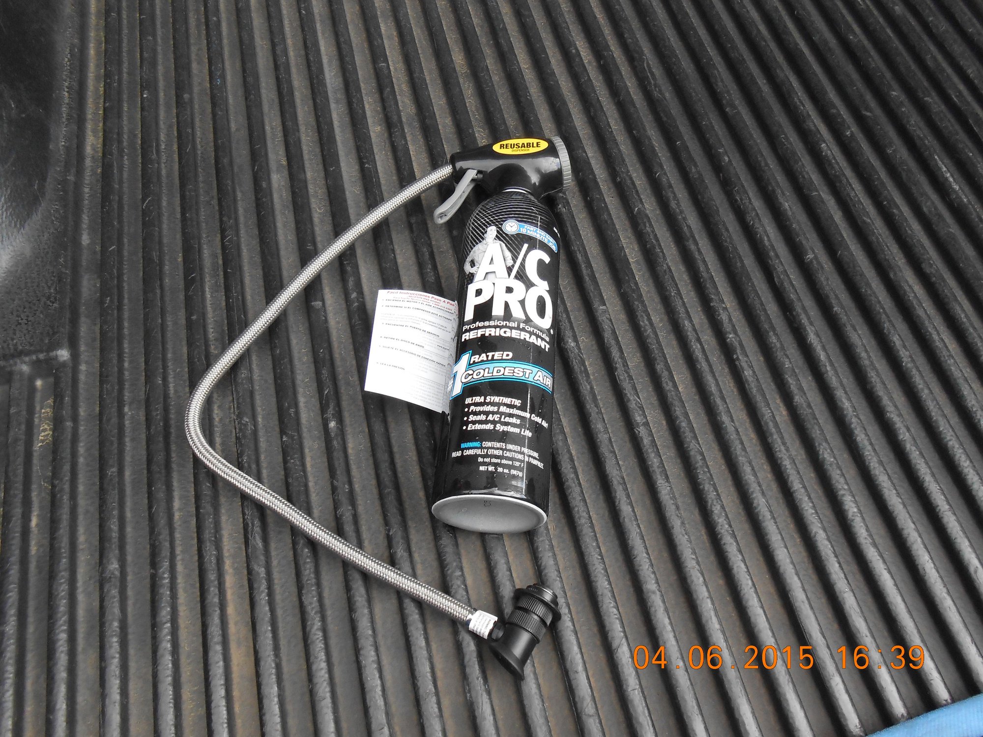

Check the fuses, then I'd start with picking up a couple cans of R-134 and a recharge hose. Fill it back up. If you are uncomfortable doing this, I would suggest taking it to a qualified repair facility to have a diagnostic check performed.

I buy mine at Walmart. It's really easy to do. You probably have a leak, ideally yes, you should have the leak repaired and the system properly evacuated and refilled, but in a pinch the method I suggest will suffice. I've been refilling my
95 Chevy every summer for the last couple years. I have a slow leak somewhere, but am too cheap to have it repaired, so I just throw a couple cans in every spring. Gets me through the summer.

No problem. If you've never done it, look at a few videos on you tube. It's really easy though. Turn the engine in, ac set to max. Connect the recharge hose to the low side port (it only fits that one, the smaller of the two ports) add till the can is empty. There should be a label under the hood staying the maximum refrigerant charge. Don't exceed that rating.

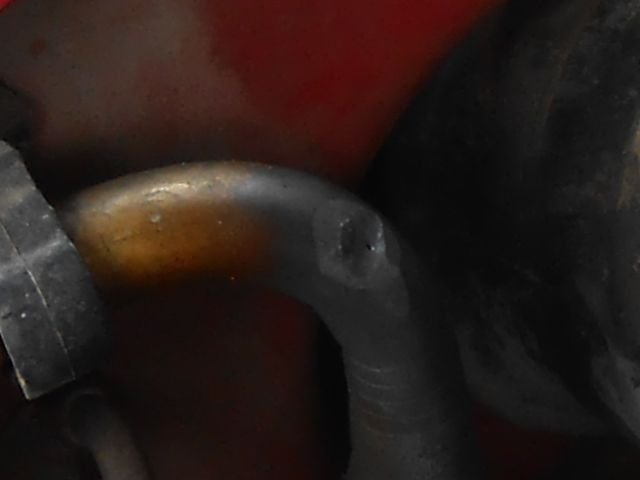

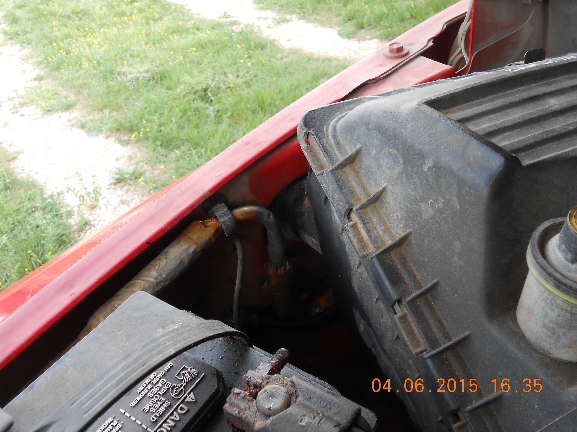

Well I think I've found my problem, small pin hole rubbed in the piping by the air filter housing. What's the best way to fix the pin hole? Will JB Weld or something similar work?
Old Apr 6, 2015 | 06:31 PM
Posts: 28,198
Likes: 363
It's best to replace the line. You're dealing with a lot of pressure.

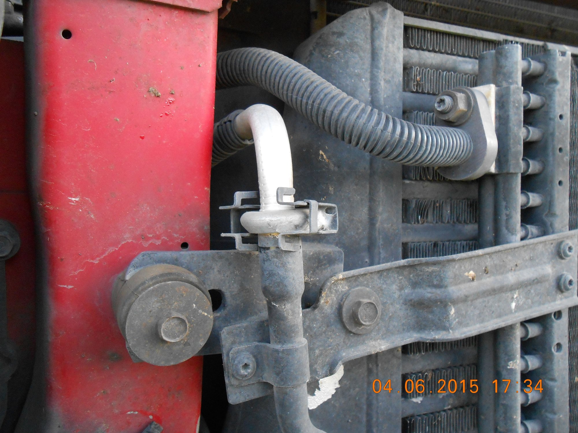

Thanks jkeaton, I found both ends that look like where a connection of some sort is, I'm guessing that metal clamp comes off and the fitting just pulls apart? Also, what is the name of this line? Thanks, again
