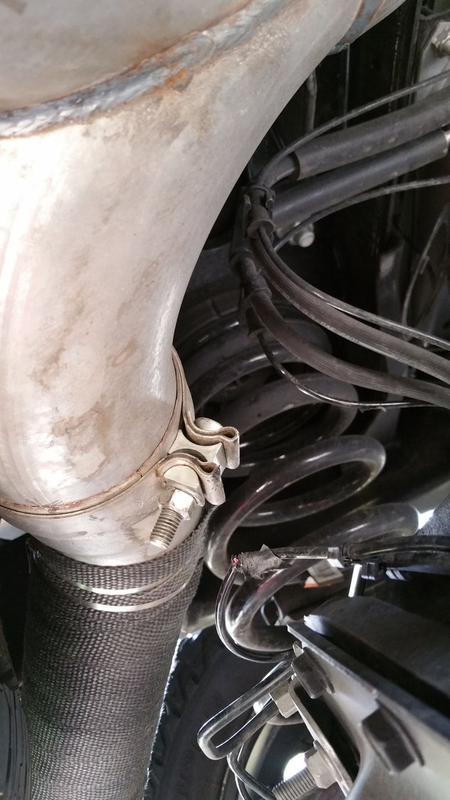

So i looked over all my Abs lines again and finally found the problem! The exhaust clamp on my dual exhaust hit my rear diff and split the wire right where i couldnt see it on top of the diff. So after finding that i soidered it back together, sealed it, taped it and tie straped it in a safer location. Then i loosened and spun the clamp higher so not to hit my rear diff. Problem solved! For that at least.

Good find. Aftermarket exhaust, isn't it?

From: Texas Yall
Yep, i had a feeling it had something to do with the exhaust. Thats why i checked again. Im suprised i was able to find it with how small the cut was and the location.

Yep, and being caused by aftermarket if you'd have brought it to dealer they'd have charged you major coin for the minor repair...
