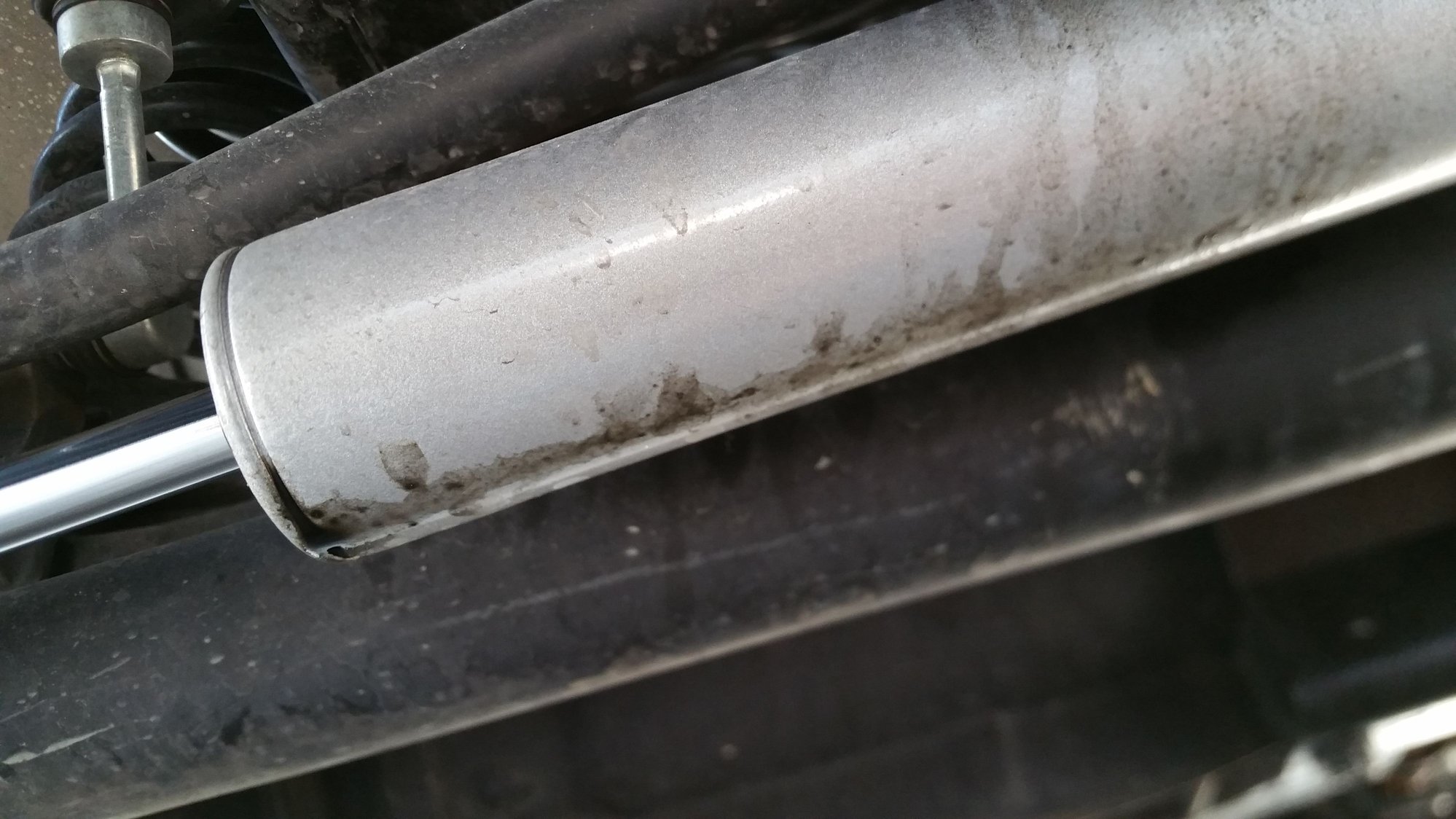

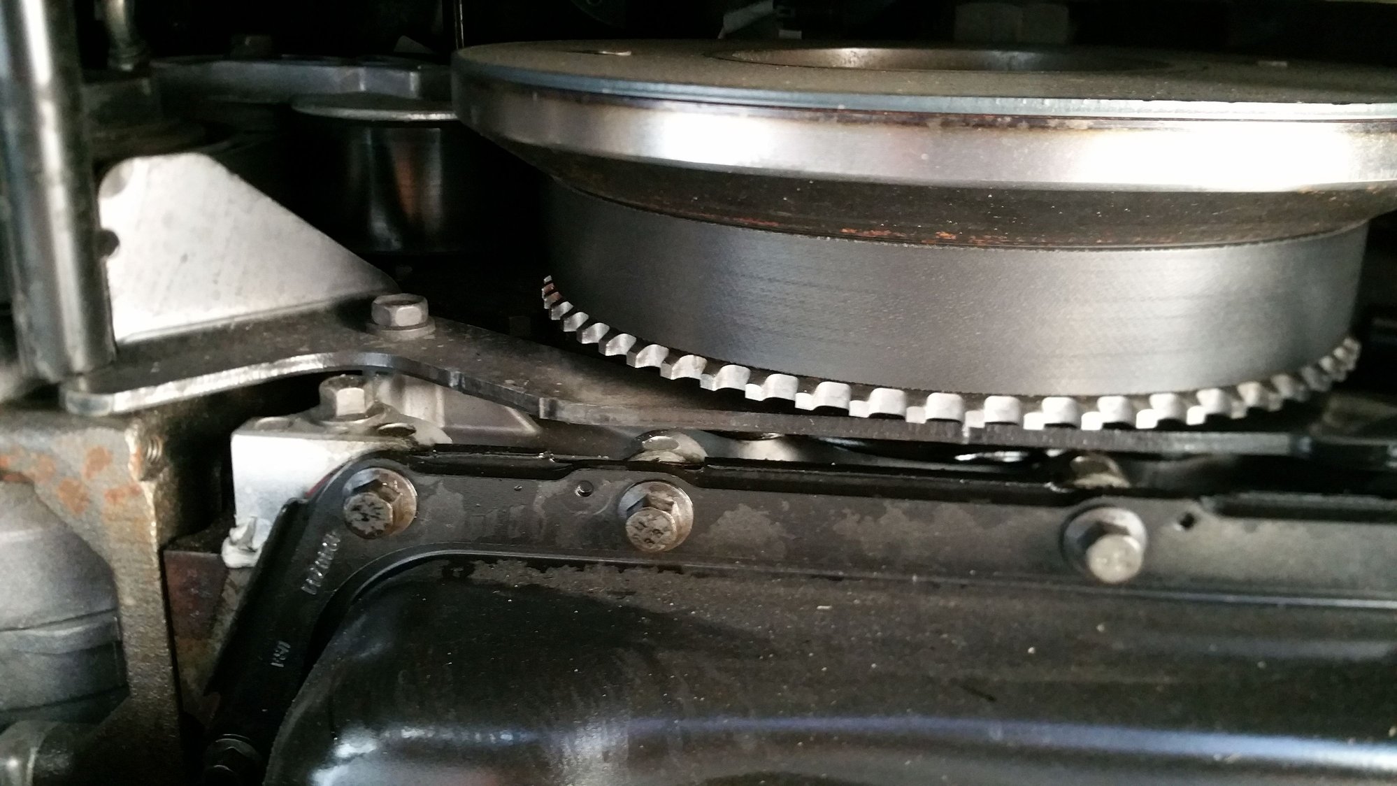

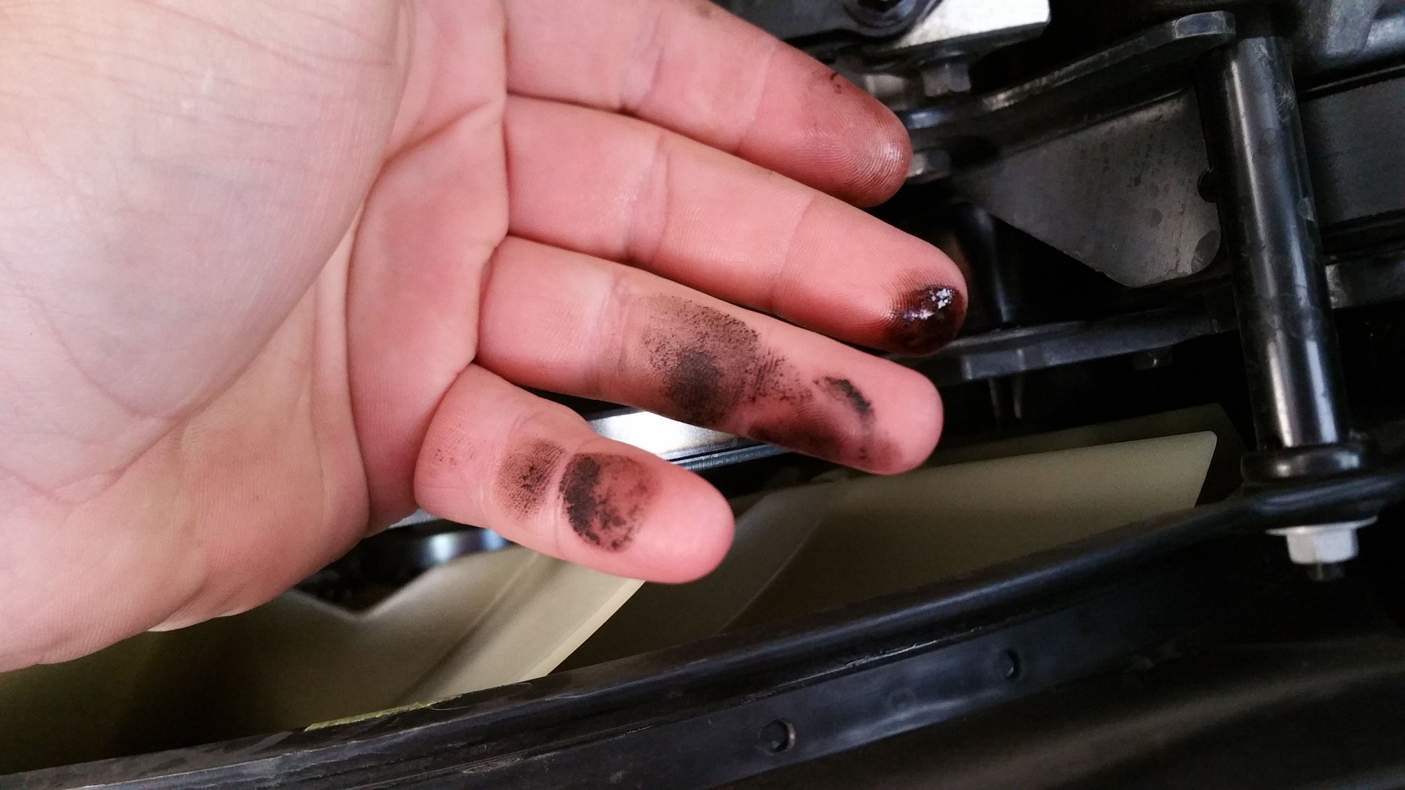

I crawled under my truck today to kinda check the electronics out and Abs sensors and noticed Oil!!! Looks like its seeping front the front of the oil pan seal, damn is all i can say!

I haven't changed the oil yet, just sitting a little over 5,500 miles on it. Im fixing to crawl under my truck and spray degreaser and clean it off. Then ill check it daily to see if its still leaking. What is the plastic catch like plate under the oil pan for anyway, the oil catch for the oil filter.

Clean it and see if it comes back or where it's coming from. Odds are it's just assembly lube...

Ya the plastic tray is supposed to funnel the used oil into a catch can if you pull the filter from the wheel well. Stupid design- makes too much of a mess for me.
I pull the intake duct work and remove the filter from the top, no mess.
I wanted to say that it could have been assembly lube initially, but that does look like used oil on the stabilizer.
Make sure your filter is on tight and there aren't any leaks from the o-ring to the cooler.
Also, make sure the auxiliary plug on top of the oil cooler housing is tight and not leaking.
Other than that, my guess is pan gasket or something from the timing cover area.

I know this is a fairly common thread across all five diesel truck forums I keep up with. Not just Ram but GM and Ford as well and 99% of the time it's assembly lube. Even seen post from a diesel mechanic swore it was an oil leak until he got it on a lift.
I think I can remember one 2013 Ram owner where it was the timing cover and actually ended up being a buy back truck because of it. Only leak I've seen you could even stretch to call "common" would be the pinion seal, which this is obviously not...

Oh I have read all about assembly lube and such and agree with you, but the leak on the stabilizer looks alot like sooty used 6.7 oil.
Just an observation.
Really hope it is, in fact, assembly lube.
