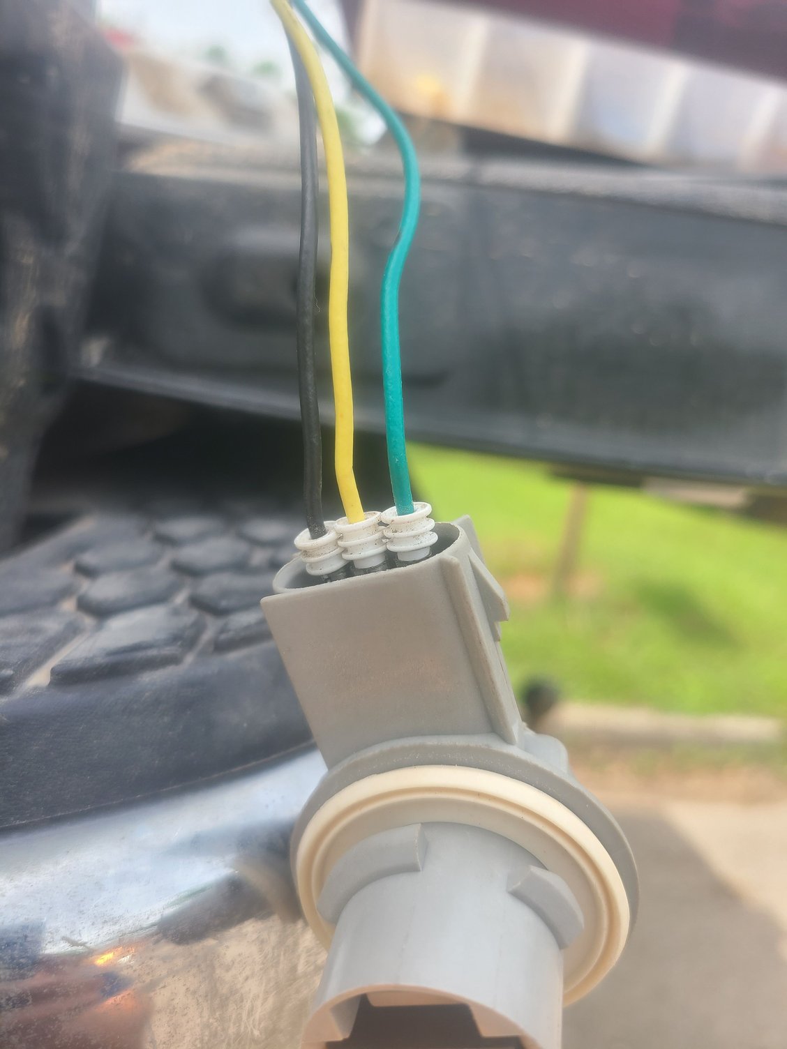

Back right side of truck got hit and broke the tail light. Instead of buying the $350 ea tail lights to replace it I got two $50 ea incandescent bulb tail lights (Because Im Cheap). The old tail light had 4 wires that went to the Brake/Blinker lights (Red, Black, Green, Yellow). When I set up the incandescent Bulb Tail lights though it only had three prongs everything works with just the Yellow, Green, Black (Brake Light, Blinker, Night Light) Red Wire didn't do anything when plugged into anything (I assume because the old ones were LED) Is the Dash throwing warnings that the Blinkers are out because it doesn't see any resistance on the red wire? The Red wire is out of frame on the picture.

Yeah, that would be a safe bet. It's probably a 'sense' wire, that looks to see if current is passing thru the bulbs.
Try going here, looking up what the wires are supposed to do. (I am reasonably sure the site is safe. An adblocker being active wouldn't be a bad idea though. )
