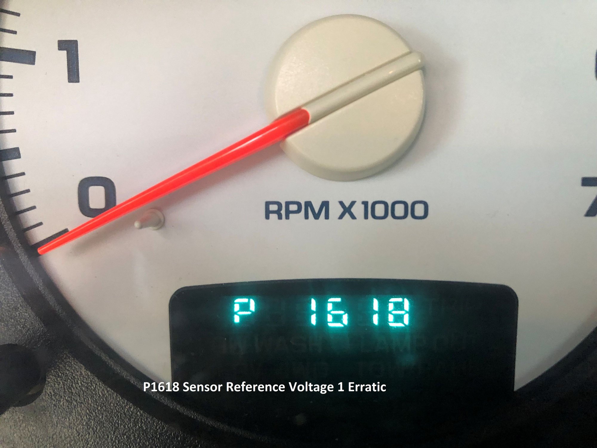

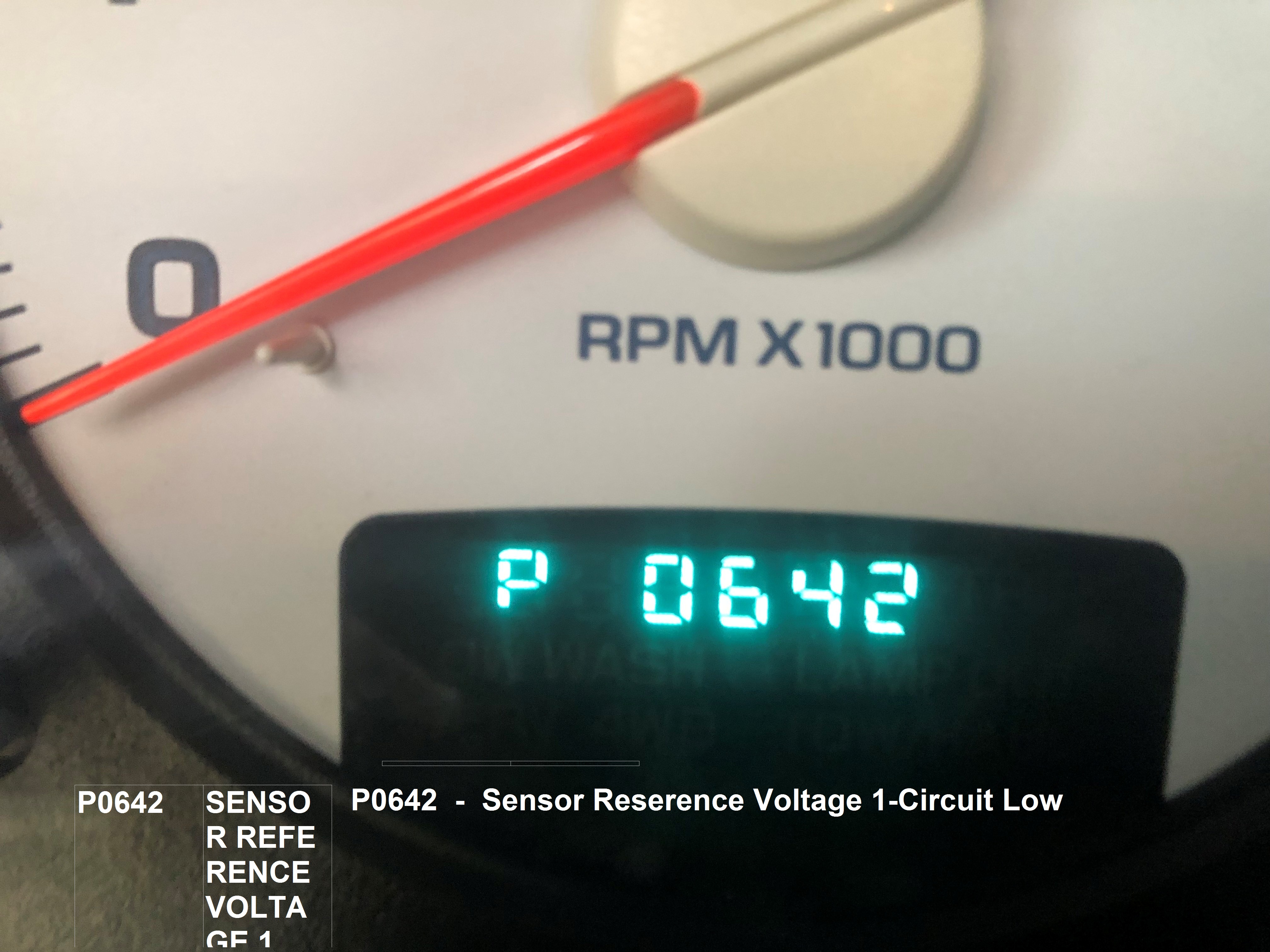

1-P 0642 code 2- P 2122, code 3- P 1618, several mechanic scan and all they said is electric issue but where ? no one know any way lighting bolt light coming on sometime so i was told to change TB i order and mechanic change for me next day happen again and aging . so this time crank shift sensor is change and nothing different . dealer told my i should left my truck in the service department . maybe 2 hours maybe 10 hours charging me $175.00 per hours so hope some ine can help me and not sure if they going to find

If the sensor reference signal is low, ALL of your sensors are going to be wrong. Got wiring diagrams? Gonna need 'em to trace the power loss.
