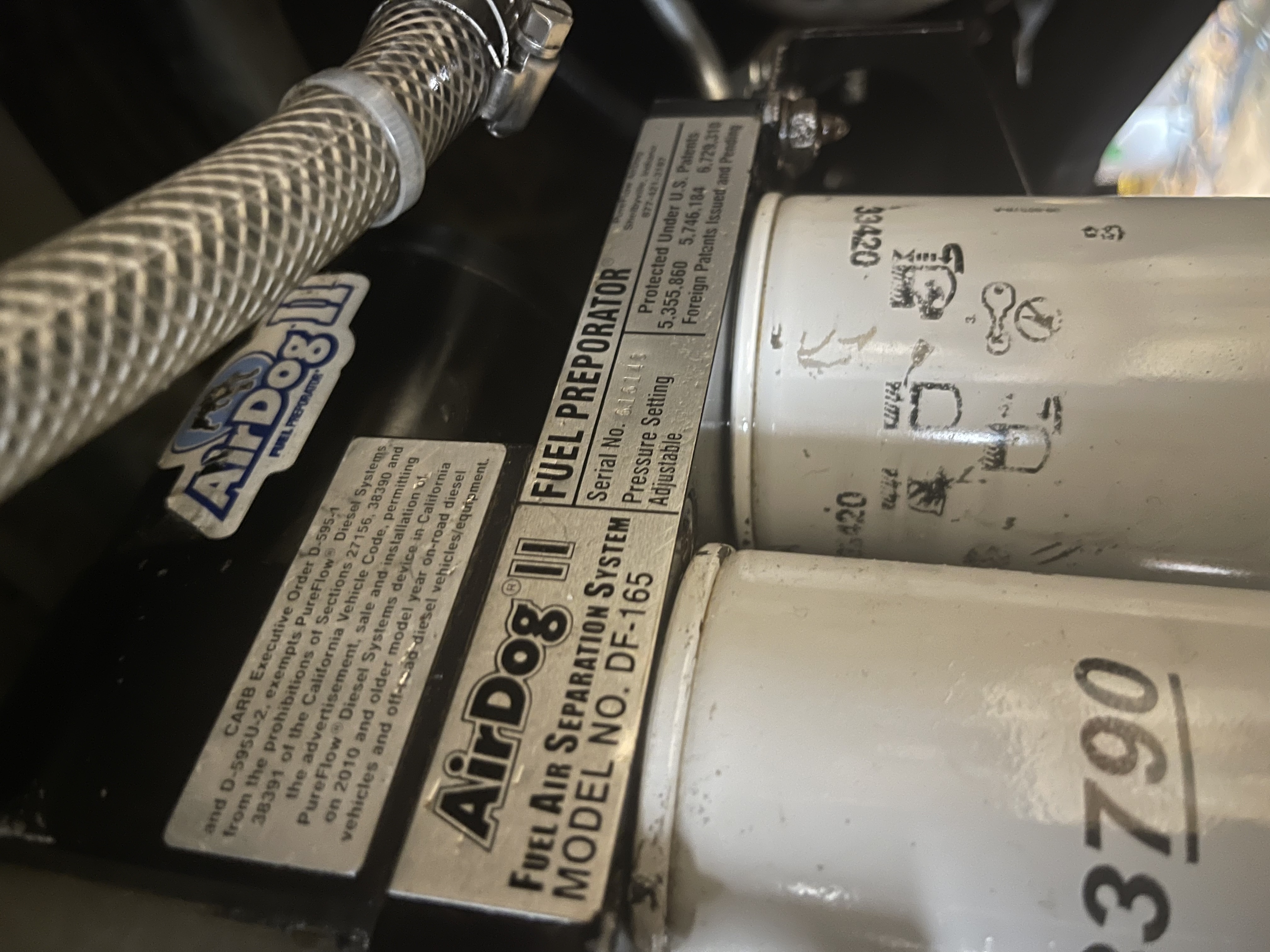

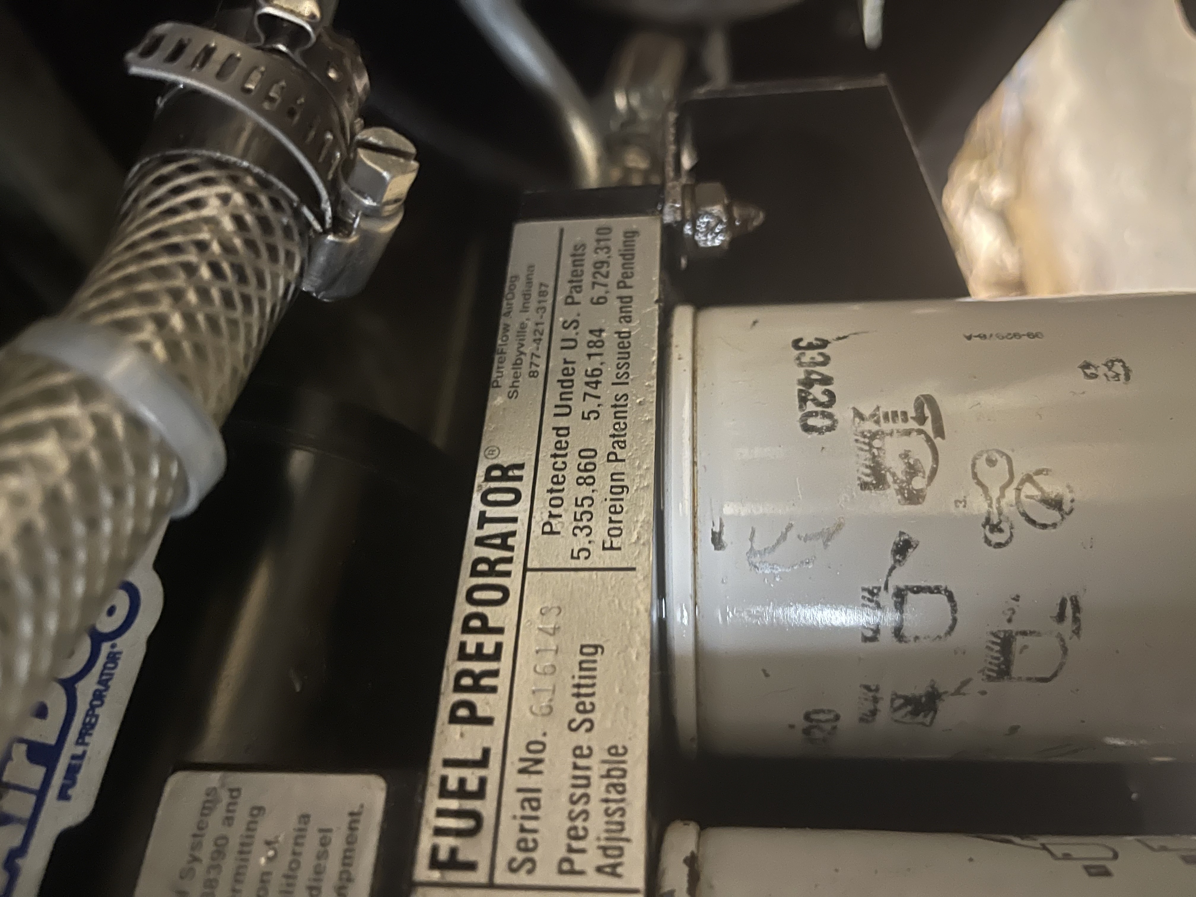

Default Model number
Exact model number is as pictured.
Attached Thumbnails 01 5.9L turbo Cummins 4x4 dually fuel system swap question-270e544c-ce09-4b2c-b265-53b2c07e5031.jpeg   01 5.9L turbo Cummins 4x4 dually fuel system swap question-3a2b1173-b5f7-4392-a1d7-f45b5ae10177.jpeg
Old Apr 7, 2023 | 03:14 PM
Posts: 87,478
Well, it says 05-15.... So, technically not the right one for your truck.... Output pressure is 15 to 17 PSI on that one, I don't know what output pressure on the stock pump is.... It also suggests its a variable flow pump..... though how it accomplishes that, I don't know. It entirely possible that it either doesn't put out enough pressure for your motor, or, the 'variable flow rate' isn't working the way it is supposed to, and it simply isn't moving enough fuel...... I might be tempted to put a gauge T'ed into the output, (somewhere that you can see it...) and go for a drive. See what pressure is doing when it ain't running right.
Ok, looked it up, stock pump is minimum 10 PSI, 7 while cranking. It seems that it uses a lower pressure for cranking. (and this is on purpose.) Max pressure appears to be about 15 PSI...... But, yours starts fine, and runs... just not well. I don't think that pump is your issue. Something else is going on there. Any codes showing??
