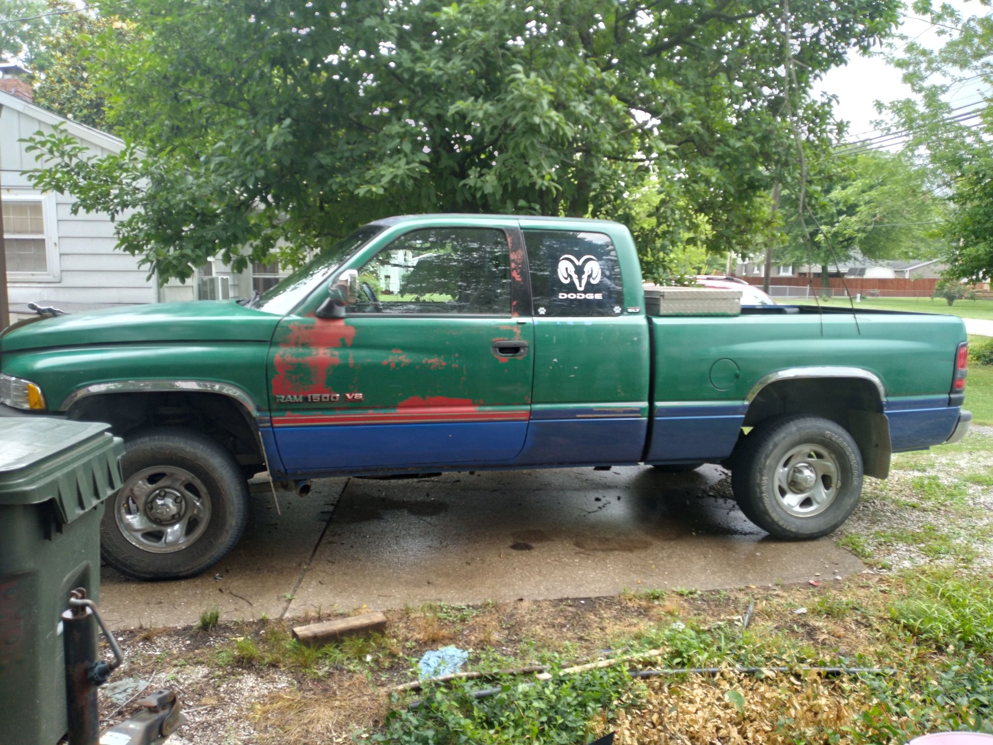

That's right. There was a problem with 5th gear back then. I had forgotten about that. It sounds like you have a good solid truck there. I've got a '96 myself. (1500 gasser.) What cab and bed combo do you have? I've got the extended cab, short bed myself. The drive train and suspension are lighter on my unit but they are the same otherwise.

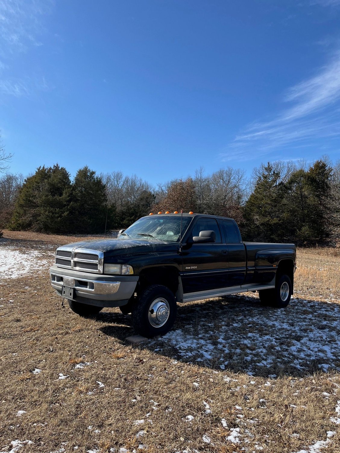

hey ol grouch glad to hear from you, she's an extended cab dually with an 8 foot box. Tryin' to think of a good name for her but for now all I got is 'baby darlin'. Attached a pic. From the looks of it the previous owners seemed to have cared for her. But again, one never knows what might be amiss, which is why I'm fixin to get more learned eyes on her. Hopefully not much is wrong. But I intend to take care of her as well as possible. A big part of that is digging into learning resources on these 2nd gens and talking to wiser men than me.

I don't know about being wiser, I just usually buy older stuff and have to fix it. That is one sharp looking truck. Don't be in a hurry. I've found vehicles will often name themselves. My '96 didn't have a name when I got it.
After I did a "Farmer Chic" paint job, it named itself.
Meet "Fiona".
Your truck looks like it was a long distance runner. Something like pulling a camper or such. Eventually something will happen that suggests a name. I had an '84 named "Black Betty". The name came from a neighbors daughter. Personally, I didn't think an 11 year old girl should know that song, ut the name did fit.
