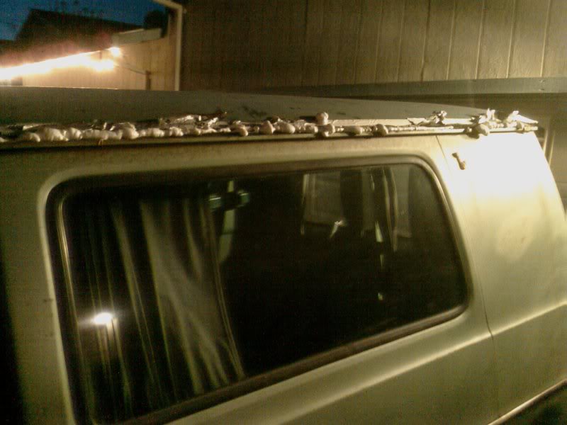

I bought a 1973 Dodge van for cheap. It's got a big ol' 5.9L (360ci) V8 and can tow my other cars on a trailer. Which is all fine and dandy. Except the roof is rusted to all heck. The middle and top of the roof is fine. The sides, where it connects to the body, have rusted through. Basically, only the roof beams are keeping the roof attached to the van. Needless to say, it leaks a fair amount and I'm going to be getting some rain soon.
I'm just interested in a quick and dirty fix so I'm going to just fill the backside of the roof with expanding foam. Then sand, seal (somehow), prime and paint.
Here's what I'm working with:
Any warnings, encouragement, or other cheap ideas for a fix?

Expanding foam will not handle the vibration and movement of the metal panels. I suspect it will start falling apart within days. My suggestion for a cheap and quick fix is a roll of flashing. You can buy a roll of 4"-6" wide flashing at a place like home depot along with a couple of tubes of silicone, and a couple packs of rivets or self tapping screws. Surround your rusted out areas with the silicone, plus a little space for the screw/rivet penetrations. Roll the flashing out and attach it to the roof. Once you're done, a quick coat of Rustoleum should hold you over for a while.

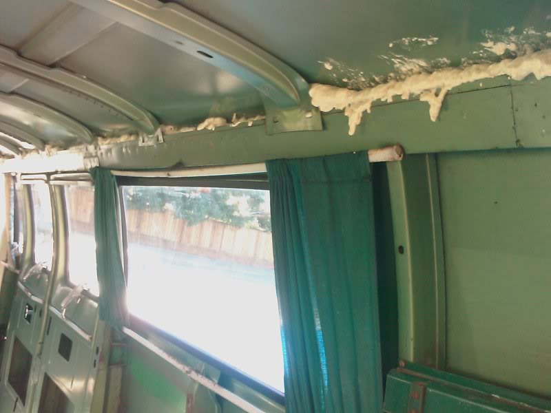

Went home on my lunch break and filled one side of the roof "shelf" with foam. Says it'll be completely dry in 4 hours -- we'll see. I only did one side (the side that wasn't in horrible shape) because the wiring harness runs down the driver's side and I've got a short somewhere in there I want to take care of before filling the cavity.
Hmm, flashing + rivets sounds like a very good idea. I'll see how this stuff holds up for a few days and if it looks like there'll be problems, I'll try your idea. I'm hoping that the foam will provide enough support that the roof doesn't vibrate much (and thus, doesn't destroy the foam). Time will tell....
I used regular expanding foam for this side. I think I'll stop by a boat store and pick up some marine foam for the other side (where it has rusted completely through). I've still got a few tubes of silicon sealer if I need to use that on the flashing.

I figured the heck with it and foamed up the other side as well. It'll be dry in about 3 hours. Tomorrow, I'll take it out for a spin and see how it's treating me.
Total cost so far: $10.98 for 2 cans of foam.
Anybody have experience with the UV-hardening fiberglass things like Solarez? I was thinking about putting a layer of that over the foam.

Here's the driver's side (the bad one) with foam spilling out. Keep in mind, this was sprayed from the inside.
