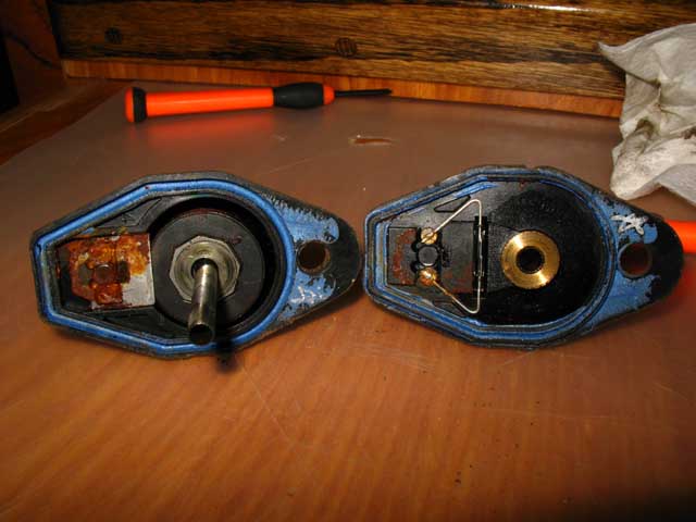

Here is a picture of the inside of my VSS. This was the first time I opened mine, and I saw that it had been opened once before, by an Aamco in Florida, who charged me for a New one. Maybe this will help you decide how much force to use to separate the cables.
