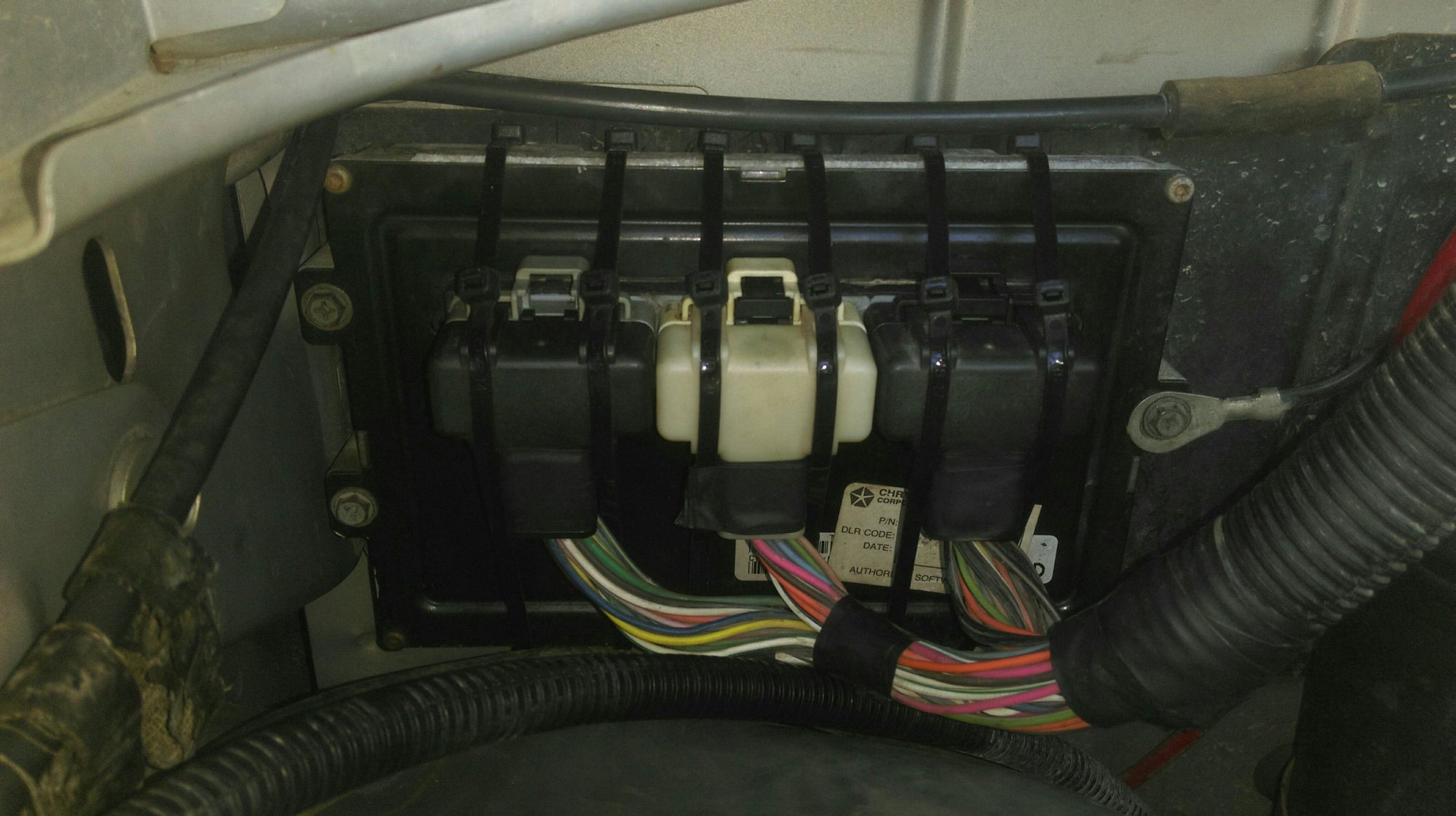

Here's a 12 zip tie solution to loose plugs & busted tabs of the PCM from a 1999 Ram.
I used a can of the CAIG Deoxit to clean all of the contacts along with a Clothes Pin and thus far there has been no more stalling during or after a 100 mile trip, drivability has improved, and mileage recorded prior has been 13.5MPG. If mileage goes up at all this will have to be one of the easiest and least expensive DIY quick fixes even for novices.
Heh, heh, good solution.

Nicely done.
Zip ties allowed me several more years of not having to fix the root of the problem, which was broken solder on the Connector pins.
I'm still stall free 9 months since reflowing the solder, and the zip ties are only to take the wire's weight off of the connector, not hold the connector in place.
