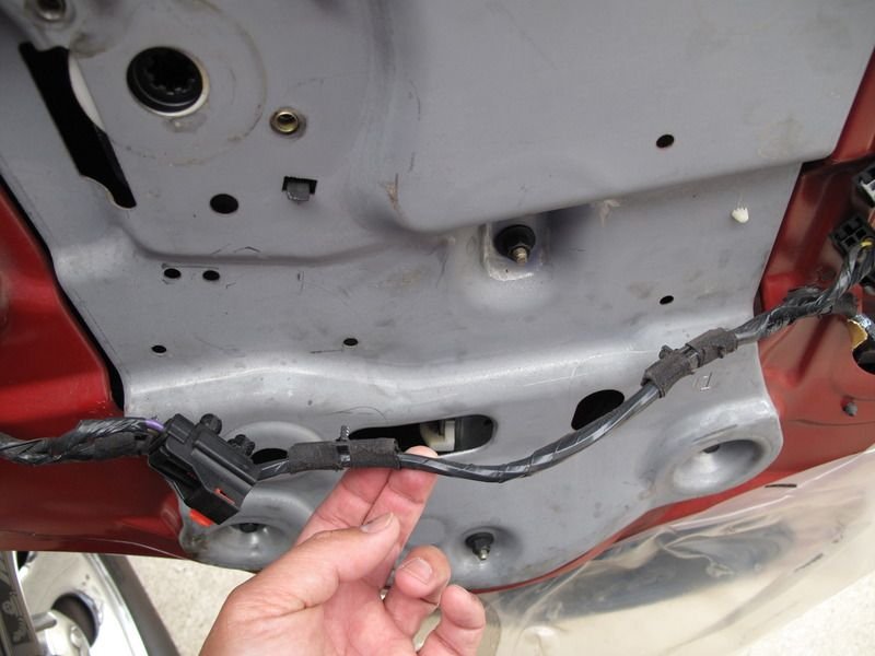

Separate electrical wire harness tabs attached to window module.

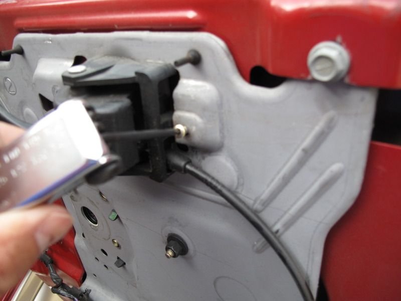

Loosen bolt to door handle and remove from window module.

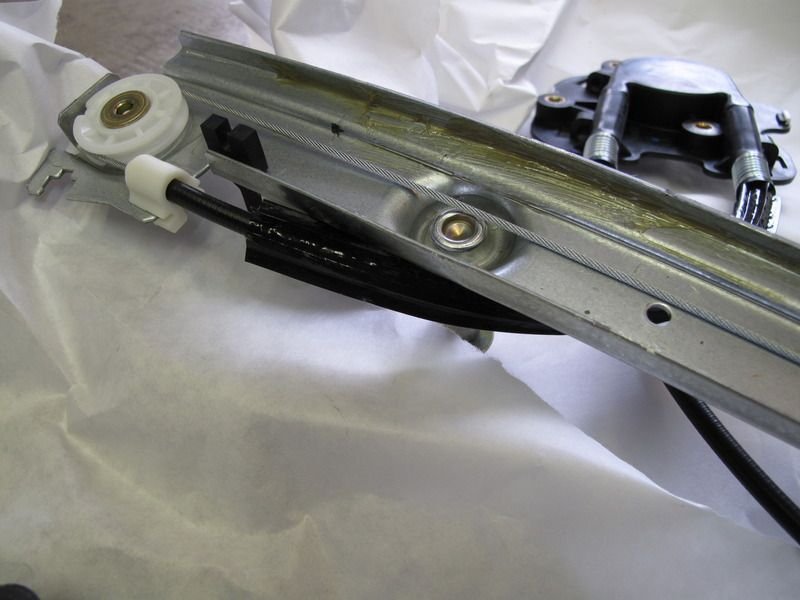

Here was the problem with the passenger side window regulator.
Here's a comparison of the old and new regulators. Note the broken bottom spring on the old unit along with the ruined rubber housing.
