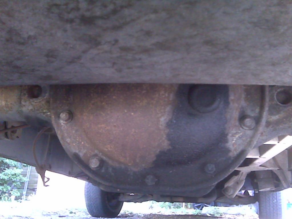

I'm draining now, oil looks brown/black with a whiteish tint, a bit thick and smells really bad.
I don't think it's the U-joints, We had them replaced in 2002. The whale drives, shifts and rolls smoothly. But it could be them, does making a loud clanging noise when shifting to reverse warrant such. I know it's not the transmission but more like the drive-train. It's never affected the performance of the van though.
Anyways...
I got three Lucas 80W-90 after finding my differential is a GL5 which uses 4.5 pints, non-slip-lock and got a new gasket. The cover/fill plug is rubber and has went bad, it's leaking gear oil, but couldn't get a replacement today so I'll probably use the old one and not drive much until the new one gets here monday.
