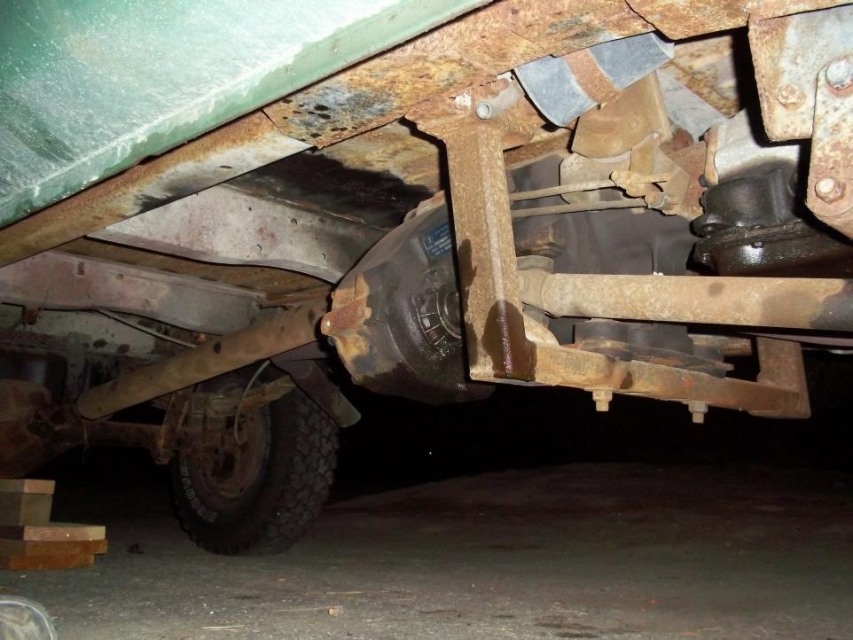

hey all,
ive had this van for 20+ years.
1975 Dodge Sportsman 1 ton 4x4(done by TerraVan)
360 with 2 barrel holly carburetor
3 speed automatic transmission
203 transfer case; 201 ratio
33 inch tires
last time i checked on the highway 14mpg on flat with tail wind
from what ive been told:
Dana 60 rear end(tag says 4.10)
Dana 44 front end(tag says 4.09)
havent driven it for 8+ years(long story). but anyhow got it goin again. i finally have the space and funds to continue restoring it and possibly put a 4 cylinder cummins diesel. i dont need too much power(just better mileage). maybe a 6 cylinder if need be. mostly highway driving. also id like to put a tranny with an overdrive(or a gear splitter kit?). any suggestions? i cant find much on TerraVan 4x4 conversions on the net. just pathfinder conversions.
mainly asking where a good place to look for a donor, what transmissions will bolt up to a cummins/my transfer case(it is married), if i should look into changing differentials, torque problems maybe. im kinda just starting to get back into this van and im not that much of a gear head to know the specifics. ive read that the dodge 1992 tranny may work for my situation. id actually not mind putting in a manual tranny. i know all this stuff will take much time but i have plenty now.

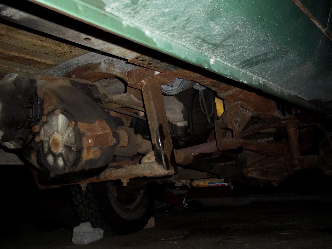

i can take better pix of the underside if anyone wants.
any input at all will be greatly appreciated.
thanx,
scotty

The Cummings 6 will not fit in our vans. The 4 will. However, the cost to swap to diesel will be in the thousands. The power and torque is about equal to a Ram Van with the Magnum 5.2L/318cid engine made after 1998.
You sir have a very rare piece of hardware. A few people over the years here have posted a few times their Ram Van 4x4 machines.
Most of us are daily drivers that work under the hood in the home garages. It's rare to find a restorer on any of the Ram Van forums I've been on.
