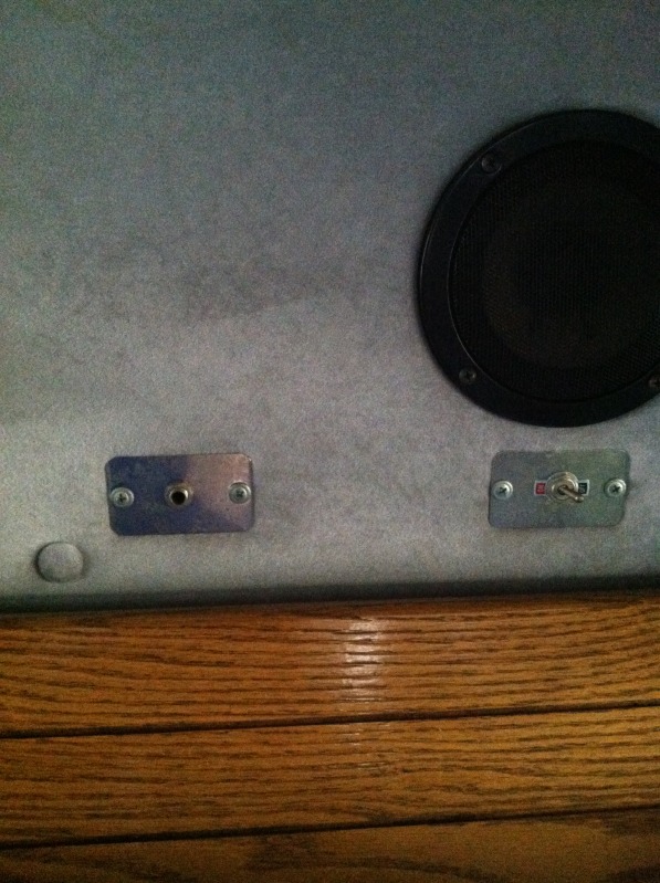

update, i had a chance to get out there and take a look at things... TV works, i just had to figure out which switch to flip fo rpower... all the running lights work, some of the "spot lights" work (im thinking a few are just burned out) i couldnt figure out how to get the back blowers to work and i have no idea what these are for...
Aw, you beat me to it. I was going to say that the one on the left is to jack in your Axe and the one on the right turns on the Marshall Stack.
